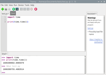

Download and install the Thonny Micro Python integrated development environment (IDE) from following web site or githhub thonny.org https://github.com/thonny/thonny/releases/tag/v3....
Run Thonny IDE
Select the Tools -- Options – Interpreter – MicroPython (Raspberry Pi Pico)
Plug in the RPi Pico to micro-USB cable for connecting to PC or Laptop. “
BOOTSEL” switch is used for selecting two start up modes of RPi Pico.
Pressing “BOOTSEL” switch, then plug in into micro-USB cable to laptop. After 3 to 10 seconds, release the “BOOTSEL” switch.
Now the RPi Pico will be identified as removable mass storage drive, called RPI-RP2 on PC or Laptop. Drag and drop the needed python (“.py”) files.
The RPi Pico drive has two more files. The file INDEX.HTM, contains the “welcome page” and information about download option of MicroPython firmware “micropython.uf2”.
Download the firmware and save it to local drive.
Drag and drop the “micropython.uf2” file to RPi Pico drive, root folder.
The file INFO_UF2.TXT, contains the information about RPi Pico boot loader version, etc.
Drag and drop the needed python (“.py”) files. The “main.py” is the first starting file, which start executes after power up.
