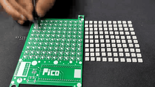

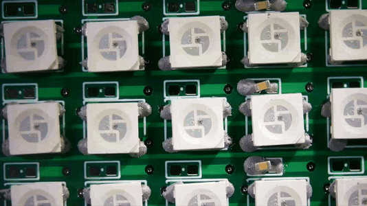

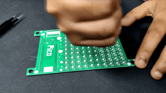

  1. Using a solder paste dispenser needle, we apply solder paste to each component pad to begin the circuit assembly process. In this case, we are using 63/37 Sn/PB Solder paste.
  2. After that, we pick each WS2812B LED and place it into their correct position.

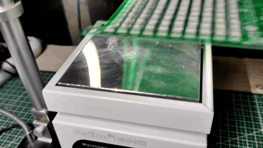

  3. The PCB is then heated from below to the solder paste melting temperature by placing the circuit on the Reflow Hotplate, which causes all of the SMD LEDs to be connected to their pads.

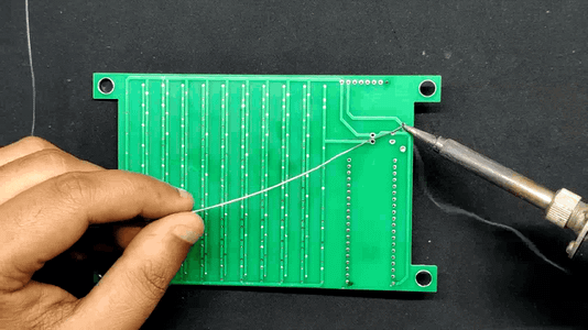

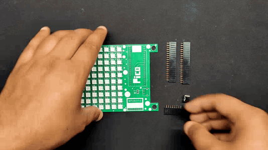

  4. After reflow, we place the THT components, which consist of female header pin connectors for the Raspberry Pi Pico and MPU6050 along with a USB type C port.
  5. Using a soldering iron, we solder the leads of every through-hole component from the bottom side of the board.

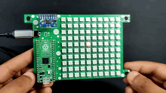

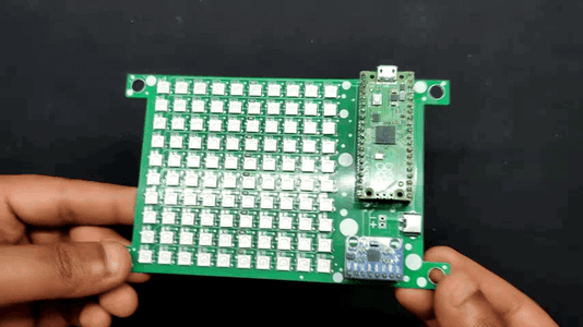

  6. Finally, we position the MPU6050 and Raspberry Pi Pico on the header pins, and the assembly is now complete.
Step 5: "MPU Control Pixel" Sketch
We start testing this matrix by uploading a sketch we created, which is essentially a pixel control sketch that makes use of the MPU6050. In this sketch, a bright pixel in the center moves in response to the MPU6050's orientation, simulating a particle of sand. For a future hourglass project that senses movement and controls pixel particles that travel around like sand particles, our goal is to refine this sketch further.

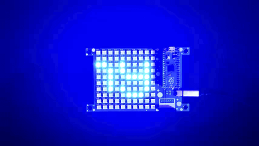

Step 6: SCROLLING TEXT
The scrolling text animation was the next interesting thing we tried. It was made up of a humorous statement that we put to our sketch and that said the following: "Why don't scientists trust atoms? Because they make up everything!"
Here's the sketch we used.

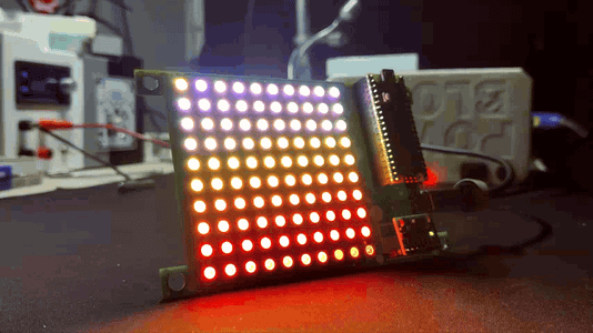

Step 7: FIRE
Next, we use one of the FastLED Library's example sketches, Fire, which imitates Flame's color palette, which is composed of red, orange, and white. This sketch is simple to use if you want to create a digital fire or fireplace project. For more intense animation, you may use a diffuser to spread the LED glow, which will make the setup look more realistic.

Overall, this project was a success and required no further revision.
Making a matrix test board that can be used to explore with WS2812B to run various demo sketches and create our own—the sand particle sketch we are working on right now—was the aim of our project. We will be sharing a future project soon that includes an hourglass demo sketch.
