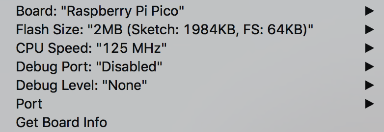

Step 6: Flashing the Pico
With the "Pico-Martix-Touch-Keyboard.ino" opened, go to "Tools" -> "Boards" and select the "Raspberry Pi Pico".
You can leave all settings as default, except for the "Flash Size". The keyboard sketch needs a small bit of filesystem storage to store the touch calibration data that is created the first time the sketch runs. So, under "Flash Size" select "2MB (Sketch: 1984KB, FS: 64KB)"
