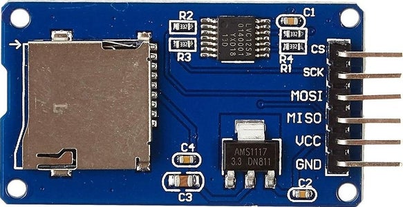

Step 6: SD Card Interface
SD Card module provides “micro-SD card socket”, for inserting the memory card and then provides SPI interface pins (MOSI = GPIO11, MISO = GPIO12, SCLK = GPIO10 and CS = GPIO13, for connecting it into RPi Pico board.
SD Card module converts the +5VDC supply into 3.3VDC using AM1117, 3.3VDC regulator and converts the 5VDC logic Pins into 3.3VDC logic pins by using “74ABT125PW, Quad Buffer Tri state logic converter”. T
he micro-SD card should be powered and operated with 3.3VDC. Otherwise, connecting the 5VDC logic into microSD card, can permanently damage the memory card.
This experiment uses an 8GB micro-SD card and it must be formatted (FAT32) on Windows 10 environment.

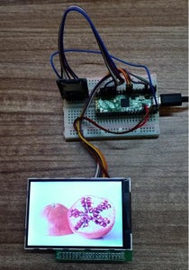

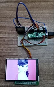

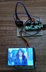

Step 7: Python Program – 320x480 TFT, Bitmap File Handling
Open the RPi Pico as drive, and then copy the bitmap files into root directory.
Copy sdcard.py into root directory

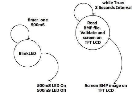

The timer_one is initialized and callbacks the “BlinkLED” functionality for toggling on board LED at 500mS duration. (frequency = 1)
The TFT LCD class provides basic firmware functionalities like Init, ResetDevice, WriteDevice, WriteDataToDevice, WriteBlock and FillRectangle.
The python program, initializes ILI9488 TFT LCD with SPI0 interface.
Python program, initializes Micro SD card with SPI1 interface.
Python program reads the bitmap files, from Micro SD card and screens one after another at 3 seconds interval.

#Initialize timer_one. Used for toggling the on board LED
timer_one = machine.Timer()
#Timer one initialization for on board blinking LED at 500mS interval
timer_one.init(freq=1, mode=machine.Timer.PERIODIC, callback=BlinkLED)
# Opens bitmap file. Displays the file @ 3 Sec interval
while True:
    for x in range(1,len(bitmap_image_files)):
        # Open file
        f = open("/sd/"+ bitmap_image_files[x],'rb')
        # Check if it bitmap file
        if f.read(2) == b'BM':  #header
            dummy = f.read(8) #file size(4), creator bytes(4)

Step 8: Conclusion
The project is successfully completed with Raspberry Pi Pico, 3.5-inch TFT LCD and Micro SD Card
TFT LCD shield 320x480 HVGA shield represent flexible in expensive display technology and can be used for many embedded projects as mixed image and alpha numerical display. It consumes less power
