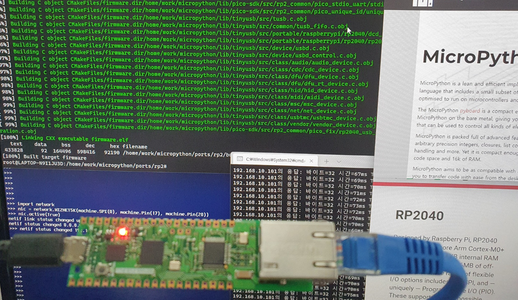

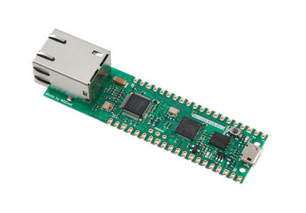

The W5100S-EVB-Pico is a microcontroller evaluation board based on the Raspberry Pi RP2040 microcontroller chip and full hardwired TCP/IP controller W5100S chip. The W5100S-EVB-Pico has the same role as the Raspberry Pi Pico platform and includes W5100S, so the Ethernet function is basically included. But in this repo, I used W5100S MacRaw mode and lwIP TCP/IP stack.
