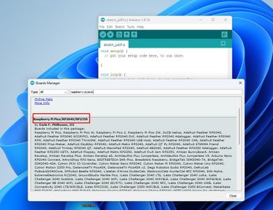

To install the given code, we first need to install support for Raspberry Pi Pico in Arduino IDE. For that purpose we go to File - Preferences - and in additional boards manager URLs we paste the given link:
https://github.com/earlephilhower/arduino-pico/releases/download/global/package_rp2040_index.json
Then in Tools- Board Manager- enter raspberry pi pico, and press install.

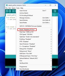

Next in Tools - Rspberry Pi 2040 - we select Raspberry Pi Pico.
Now the support is installed and we can proceed to installing the code.

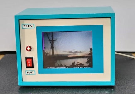

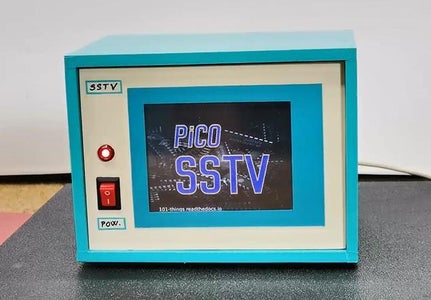

If we have connected everything correctly according to the given scheme, the Pico SSTV logo will immediately appear on the display and from that moment the device is ready to receive and process SSTV audio signals.
Test audio files are provided in a separate folder as part of the code. These are actually recorded SSTV signals from real radio reception. Now we will use them to see what the decoding of a SSTV signal looks like, in fact, with this device these specific audio signals will be converted into images.
Next, I will try to receive and decode a SSTV signal in real time with one of my radio receivers.
The quality of the received picture depends proportionally on the quality of the SSTV signal reception.
