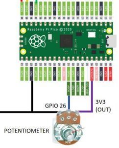

Step 1: Connecting Potentiometer
Start building the Circuit.
First connect the potentiometer to the pico as shown in the image above: Connect the middle pin of the potentiometer to the pin 31/ GP26 / ADC0. Then connect one of the remaining pins of the potentiometer to any of the grounds (GND). The third pin of the potentiometer has to be connected to pin 36 / 3v3 OUT.

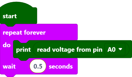

Step 9: Start Programming
The Water-level-indicator works by reading the values of the potentiometer and turning the LEDs on when a certain value is reached. Everything is programmed in PiperMake. Let‘s start with an simple ``repeat forever`` loop:
Step 10: Reading Values
Read the values from the potentiometer by using the `` print (read from pin ADC0)`` block.
