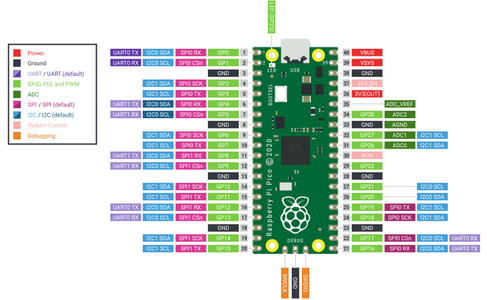

Step 2: Raspberry Pi Pico Pinout

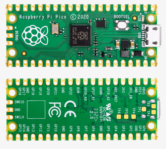

This means they can be used for endless possible applications with this small and affordable package. What sets the Pico apart from the crowd is its dual core ARM processor with flexible clock which can go up to 133MHz for such insanely low price with such a powerful microcontroller and high-performance bus matrix such that it can get full performance on both cores concurrently. The programmable I/O (PIO) that has four state machines can be used to handle data, incoming and outgoing, to offload the Pico. This feature is not available in rest of the microcontroller. Hence these other microcontrollers cause timing problems when one is trying to use interrupts to turn the pins ON and OFF directly. Besides, it takes a lot of processing resources that you may need for other things and it’s not the recommended way to use a microcontroller. This problem is circumvented in the Pico making it unique. More technical details about the Pico is given in the photo.

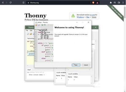

Step 5: How to Download and Install Thonny
  1. To install Thonny, go to “thonny.org”
  2. And click on the link to download for your system specification.
  3. The installation process is simple and will only take a few seconds.

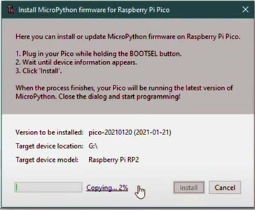

  4. Now, connect the Pico to the COM port and open Thonny, go to “tools” --> “options” --> “interpreter” --> select “MicroPython (Raspberry Pi Pico)” as the interpreter and select the COM port being used.
(NOTE: There’ll be a prompt asking to install MicroPython, click yes (as shown in the figure) and then you can check in shell that Pico is connected.)

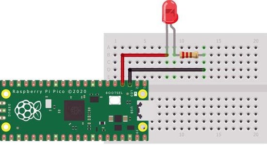

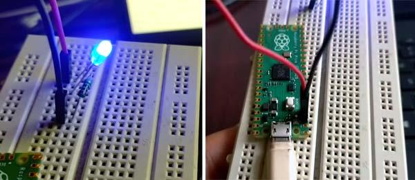

Circuit connections for Pico is very simple. Connect the LED in series with 220 ohm or 100 ohm Resistor. Connect the other pin of Resistor to the Ground pin of the Pico. Connect the GPIO 2 pin of Pico to the LED positive terminal. Now the circuit connection is complete.

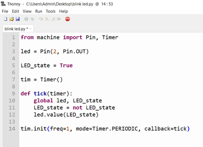

The code written is simple. GPIO pins are imported from Machine and a Timer is used to create delay of 1 second.
from machine import Pin, Timer
led = Pin(2, Pin.OUT)
LED_state = True
tim = Timer()
def tick(timer):
global led, LED_state
LED_state = not LED_state
led.value(LED_state)
tim.init(freq=1, mode=Timer.PERIODIC, callback=tick)
