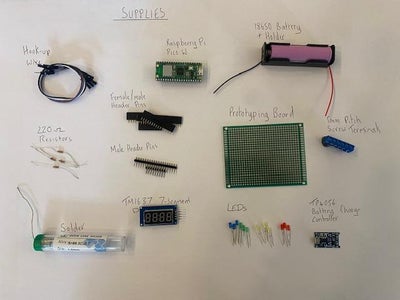

Here's a list of the materials I used:
  1. Raspberry Pi Pico W x 1
  2. Copper Dot Prototyping Board x 2
  3. TP4056 Charge Controller x 1
  4. 18650 Lithium Ion Battery x 1
  5. 18650 battery holder x 1
  6. Male / Male Header Pins Strip x 3
  7. Female / Male Header Pins Strip x 2
  8. 220 ohms Resistors x 4
  9. 3mm Blue LEDs x 3
  10. 3mm Green LEDs x 3
  11. 3mm Yellow LEDs x 3
  12. 3mm Red LEDs x 3
  13. TM1637 7-Segment Display x 1
  14. 1x6 5mm Pitch Screw Terminals x 1
  15. Hook-up Wire Set x 1
  16. 3mm Clear Acrylic Sheet x 1
  17. 3mm Plywood x 1
  18. Solder x 1

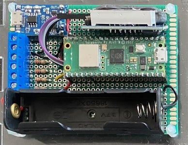

Step 1: Solder the Circuit Board
I've attached a simple wiring diagram showing how all the components are connected, please take a look.
The first thing I did was place all the components of the copper dot prototyping board to check the layout.

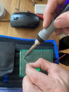

Next I soldered the male / male header pins to the Raspberry Pi Pico W. an easy way to do this is to push the header pins into a solderless bread board first to hold them into position. You can Then solder the pins to the Pico with the pins secured in place.
I then soldered all the components to the breadboard. It's good to use a fume extractor when soldering to prevent you inhaling any nasty fumes. Also safety glasses are a good idea, it's easy to forget you are holding a hot soldering iron and poke yourself in the eye when you scratch your nose!
A handy tip is to hold the components in place with some blue tack or tape when you solder them, this means you can turn the circuit board upside-down and the components will stay in place.
With the components all soldered in place I then finally soldered all the hook-up wires in place to connect the components.

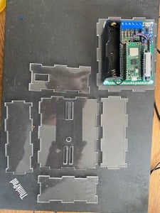

Step 2: Build Enclosure

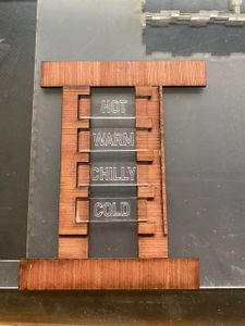

The design of the enclosure fulfilled two purposes. Firstly to safely enclose the circuit board, secondly to integrated a laser engraved acrylic sections that are illuminated the correct colour depending on the outside temperature. The laser engraving meant that I could integrate some text that illuminates with the corresponding LEDs, for example "COLD" for the blue LEDs when the temperature is cold and "HOT" for the red LEDs when the temperature is hot.
I made a 4-level laser engraved acrylic sign with each section separated with a gap to ensure they illuminated independently. The acrylic section were held in place by a frame made from plywood. I held the acrylic sections in place by making the plywood frame in the layers the middle layer had rebates cut out to support the acrylic sections in place. The acrylic frame also housed the LED modules. The illuminated frame is held in place by four slots in the main enclosure that it drops in to.

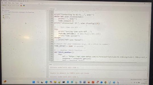

Step 3: Write Some Software
The software for this project was written in MicroPython. This project is only the second time I have used MicroPython, so it was a really good way to get some experience. I am used to working with microcontrollers like PICs, Arduino's and ESP32's so it felt quite different working with the Pi Pico. Unlike microcontrollers programmed in C / C++, you don't compile the code and upload it to the micro controller. You simply save the python programs directly onto the Pi Pico. There's loads of introductions on working with the Pi Pico so I'm not going to go into the basics of how to download MicroPyton etc. One of the best places to look is on Pico-series Microcontrollers - Raspberry Pi Documentation.
I used the Thonny IDE to write the software as I think it's great to use and there's a load of support to go with it, but I'm sure there are plenty of other IDE's to use.
I have attached a copy of the main code (main.py) and the TM1637 library (tm1637.py) for you to use if you wish, however you will need to change the location on the API request to the location of your choice.
So, here's a run through of how the code works. The aim of the code is to display the current time on a 4-digit TM1637 7-segment display and to show outdoor temperature using LEDs, which update automatically from the internet.
It connects to Wi-Fi, synchronises its clock using NTP (Network Time Protocol), and retrieves the weather from the Open-Meteo API every 15 minutes.

Section 5 - Synchronising Time (NTP)
try:
print("Syncing time with NTP...")
ntptime.settime() # Sets Pico's RTC (UTC)
print("Time synced!")
except:
print("NTP sync failed")
# Adjust for your timezone (e.g., UK = UTC+1 in summer)
TIME_OFFSET = 3600 # seconds
We are using NTP which ensures the clock is accurate without manually setting it. The returned time is in UTC, so we add a time offset (e.g., 3600 seconds = 1 hour) to match the local time zone. I'm in the UK in British Summer Timer so I need to set the clock forward 1-hour. You will need to adjust the time for your time zone.
