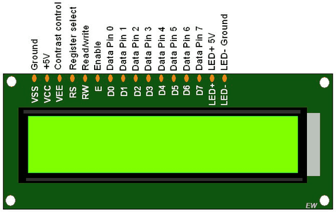

Step 1: Connecting LCD to Pico Board
Join both the bread board to each other. Insert the Raspberry pi pico board and LCD in the upper bread board as shown in the diagram. Connect the Pins of the LCD to Raspberry pi pico according to given wiring scheme:
RS ------> GPIO-21
E ------->   GPIO-22
D4 ------> GPIO-23
D5 ------>   GPIO-26
D6 ----->   GPIO-27
D7 ------>   GPIO-28
A -------> To the positive supply rail of the upper bread board in series with a 100-ohm current limiting resistor to limit the current of backlight LED of the LCD
K -------> To the negative supply rail of the upper bread board
Vss -----> To the negative supply rail of the upper bread board
Vdd ----> To the positive supply rail of the upper bread board
Vo -----> TO the viper pin of the 10K potentiometer
R/W ----> To the negative supply rail of the bread board
D0 -------> Not used
D1 ------> Not used
D2 ----> Not used
D3 -----> Not used
Connect the remaining pins of the 10K Potentiometer to the negative and positive supply rail of upper bread board respectively. This 10K potentiometer is used to adjust the contrast of the characters of the display.

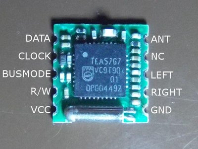

Step 2: Connecting TEA5767 to Pico Board
Insert the TEA5767 breakout board to the lower breadboard as shown in the picture. Connect the pins of TEA5767 breakout board according to the given wiring scheme:
SDA -----> GPIO-14
SCL ------> GPIO-15
Vcc ------> To the positive supply rail of the upper bread board
GND ------> To the negative supply rail of lower bread board
 L-OUT ----> T0 the 0.1UF capacitor in series with a 10K Resistor
Antenna -----> TO a long jumper wire
Also connect the SDA and SCL pins of the TEA5767 To the Positive supply rail of the bread board through two 1K resistor. These two resistors are called pull up resistors and almost always used with all I2C devices. If you don’t use the two resistors then the system will not work and you will get some error during running the program on the Raspberry pi pico.

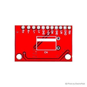

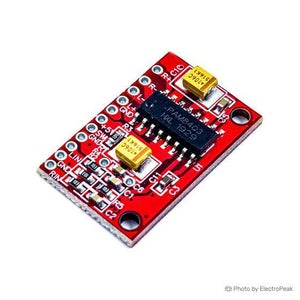

Step 3: Connecting Amplifier Board and Loudspeaker
PAM8403 is a stereo class-D power amplifier so it has two amplifier channels for left and right speakers, but here I am going to use only Left channel. Connect the pins of the PAM8403 according to the given wiring scheme.
Vcc -------> To the positive supply rail of the lower bread board
GND ------> To the negative supply rail of the lower brad board
L-OUT+ -----> To the positive pin of the Loudspeaker
L-OUT- -----> To the negative pin of the loudspeaker
L-IN -----> To the viper pin or middle pin of 10K potentiometer
