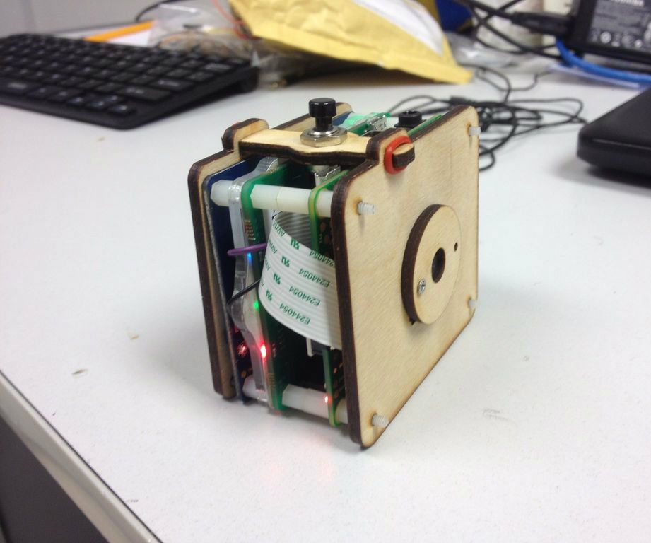

I started off using the PiJuice when I built the Raspberry Pi Compact Camera, and that's when I realized it's potential to be used in this Portable Games Console.
