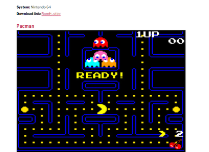

Step 4: Install Games Into ROMS
Install games into ROMS
Download the games linked below:
https://raspberrytips.com/best-retropie-games/
Put the installed games into ROMS in your RetroPie Setup
In the example above I chooses to download the Pacman Game

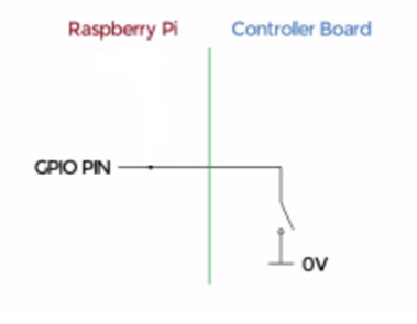

Step 5: WIRING
First, we need to work out is how to connect the buttons to the Raspberry Pi.
You only need to connect one of the button’s pins to the Raspberry Pi (GPIO PIN) and the other to 0V (Ground PIN)
Mapping The Buttons
Now that we know how to connect the buttons, we need to work on connecting each button to the right GPIO pins.
The full set of buttons we need is:
up, down, left, right, A, B, X, Y, Start, Select.
This gives us a total of 10 buttons inputs to connect to our GPIO header.
I’ll be wiring up my controller as shown above.
For testing purposes, I made the connections on a breadboard.

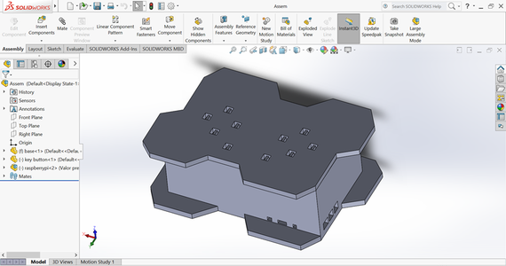

Step 7: Modelisation
3D Design for 3D Printing
Software is important. Your choice of software affects your design process. For this article, I'll use SolidWorks.
SolidWorks is very powerful CAD software with many tools for 3D modeling, simulation, assembly, and manufacturing solutions.
2D Design for 2D Printing
I designed several iterations of the joypad using SketchUp, a free and easy-to-learn tool for 2D, 3D modelling. I already had a basic shape and style in my head, but the modelling process helped me figure out the angles and dimensions that worked best aesthetically.
Prepare files for the Laser Cutting Machine
Before sending the File Box in to the Laser Cutter, we need to Export at first the SketchUp drawing to a DXF File.
I’ll use RDWorksV8 Software to send Files to the Laser Cutting Machine
