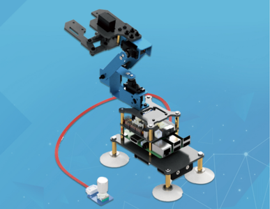

Raspberry Pi, any robotic arm (# of motors don't really matter as you can adapt the code to it anyway), a computer
Step 1: Building the Robotic Arm and Downloading Prerequisite Libraries
Follow https://www.adeept.com/learn/tutorial-296.html for how to build the robotic arm we will use (you can remove the claw if wanted, or kept if desired).
Set up your Raspberry Pi so that you can SSH to it and control the Raspberry Pi remotely from your computer terminal line (you can follow any tutorial, https://www.onlogic.com/company/io-hub/how-to-ssh-into-raspberry-pi/, this one is an example).

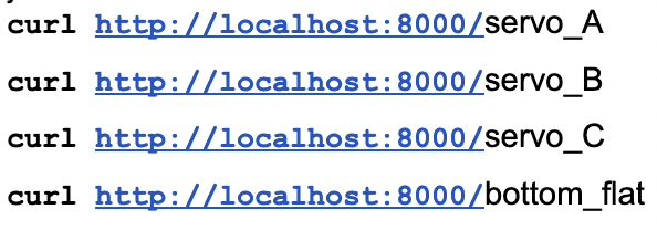

Method 1 (curl):
Opening up another terminal, we can utilize the curl command to access the API.
Running GET requests requires just using curl with the domain name + the request name, which is either Servo_A, Servo_B, Servo_C, or status
Running POST commands requires data input, so here is the format:
curl --data "oxxoxxoxx" http://ipORlocalhost/multiple
This example utilizes curl to run the post_Multiple function to move all 3 motors at the same time, but the same can be done by utilizing Servo_A or any of the other commands with the appropriate data.
