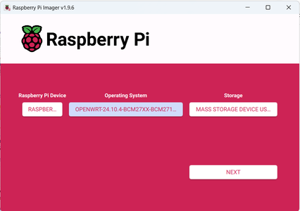

Next step would be to download Raspberry Pi Image software which will be used to flash the SD card with the installation file. The software can be downloaded from here. Download the imager software, install and open it.
First, select the correct device from the list. Just a reminder, we are using Raspberry Pi 5.

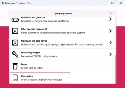

Second, choose the operating system. When the pop-up windows appears, scroll down to the bottom and select “Use custom” options, then select your downloaded installation file.
Third, mount your SD card onto the computer and select it from the list.
Fourth, start the installation by pressing the button Next. When the pop-up windows appears, press No. On the second pop-up windows, press Yes.
Now wait a couple of minutes for the flashing process to finish.

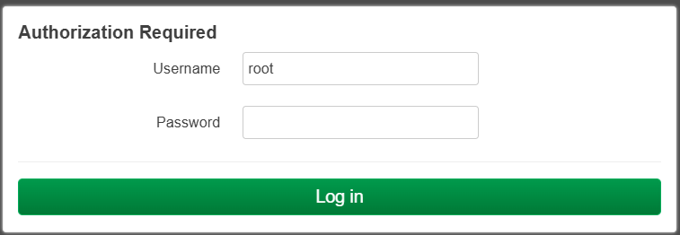

Using your favorite internet browser, connect to your router. In the URL bar, enter your device IP address. If everything was done correctly, you should see the login page.
Press the Log in button and you will be logged in to the system.
For security reasons, don’t forget to set the password for you device.

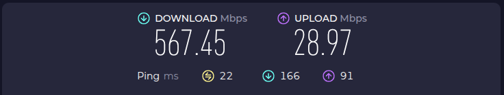

Step 5: Internet Connectivity Testing
The simplest way to check if we have internet connectivity, that I can think of, is by visiting the speed test website.
Here’s the results of the speed test.
