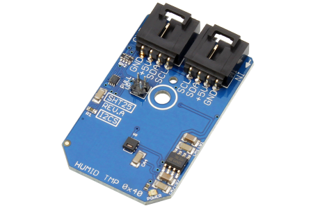

SHT25 I2C Humidity and Temperature Sensor ±1.8%RH ±0.2°C I2C Mini Module. The SHT25 high-accuracy humidity and temperature sensor has become an industry standard in terms of form factor and intelligence, providing calibrated, linearised sensor signals in digital, I2C format. Here is the demonstration with a Java code using Raspberry Pi.

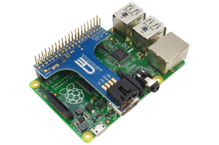

Take a I2C shield for raspberry pi and gently push it over the gpio pins of raspberry pi.
Then connect the one end of I2C cable to SHT25 sensor and the other end to the I2C shield.
Also connect the Ethernet cable to the pi or you can use a WiFi module.
Connections are shown in the picture below.
