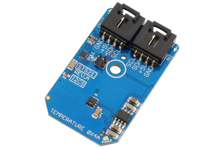

STS21 Digital Temperature Sensor offers superior performance and a space saving footprint. It provides calibrated, linearized signals in digital, I2C format. Fabrication of this sensor is based on CMOSens technology, which attributes to the superior performance and reliability of STS21. The resolution of STS21 can be changed by command, low battery can be detected and a checksum helps to improve communication reliability. Here is its demonstration of interfacing it with Raspberry Pi using Python code.

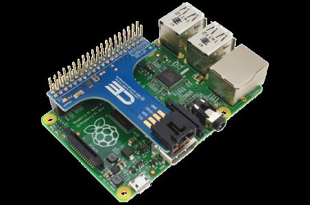

Take an I2C shield for raspberry pi and gently push it over the gpio pins of raspberry pi.

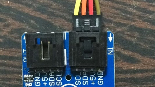

Then connect the one end of I2C cable to STS21 sensor and the other end to the I2C shield.
Also connect the Ethernet cable to the pi or you can use a WiFi module.
Connections are shown in the picture above.
