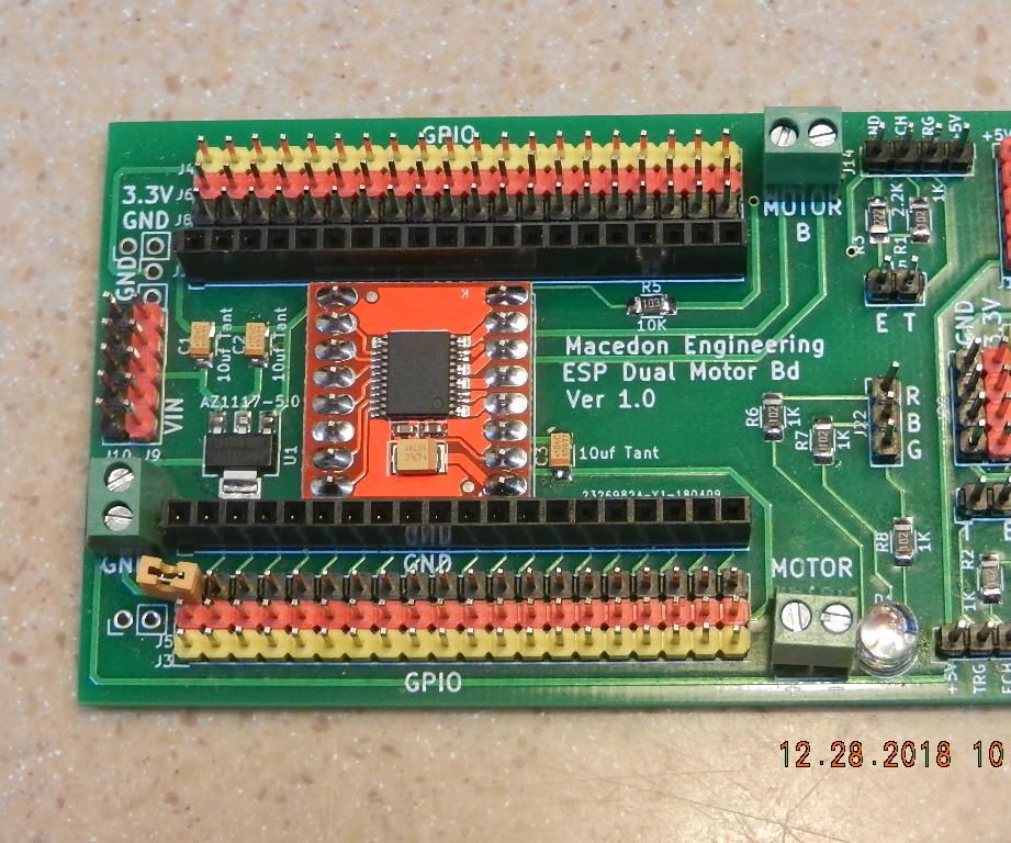

Step 2: Hub75 Interface Board BOM
You can ignore this if you purchased the Adafruit Hub75 Interface board. If you are hand wiring your own board then you may want to use through hole parts instead of the surface mount parts called for. In that case consider this more of a guideline. The BOM is detailed as two assemblies, a bare minimum and the ad-hoc optional assemblies. The first picture above shows the minimum parts required.
Minimum Build: Reference - Description ------------------------- Mouser P/N ------------- Digikey P/N TB1 - 2 position Terminal block, 5mm pitch, 651-1792863, $0.30, 277-2518-ND, $0.30 IC1, IC2 - 74HC245DWR, 595-SN74HC245DWR, $0.50, 296-1197-1-ND, $0.52 J9 - 2 - 1x20 Socket strips, 855-M20-7822046, $1.90, 952-1905-ND, $1.89 J8 - 2x10 Socket 855-M20-7830546, $1.38, 609-3573-ND, $1.43
The BOM calls out for 74HC245DWR. Any part 74*245DWR will work. So 74LS245, 75ALS245 or 74AHC245 will all work. The important thing is that it is 74xxx series, 245 (indicates an octal bus transciever) and that the wide surface mount package is used (DW indicates SOIC-20W package). CMOS (HC or AHC) is preferred over TTL (LS or ALS).
If you do the minimum build and leave out the AS1117-3.3 regulator then you need to solder a jumper wire to the two holes of J18. Doing this allows the 3.3V from the Raspberry Pi to connect with the 3.3V pins of the I2C headers and the 3.3V header associated with the unused GPIO. Leave the jumper out if you add the AS1117-3.3 regulator. When the jumper is left out the AS1117-3.3 handles the load for the added peripherals. It prevents overloading the Raspberry Pi's 3.3V regulator.
For the minimum build you should also place a jumper from the center pin to either of the outer pins of J11. This jumper selects 32 row or 16 row operation. Place the jumper to correspond with the RGB LED matrix that you are using. If you leave out the jumper then your display will look very weird. In place of a wire jumper, you could add a three pin post strip and then use a two pin shorting plug to select 32 or 16 rows.
Tip: You may find that you can save about a dollar by using two 2x10 sockets for J9 instead of two 1x20 socket strips.
Tip: Buying all your parts from one vendor will save you shipping costs.
Tip: I prefer to buy forty pin female socket strips and cut them down to the size that I need. You sacrifice one position each time you make a cut, so a forty pin strip will not yield two twenty pin strips. However, two forty pin strips, each cut twice (cut at 21 then cut the 19 pin piece at 11), will yield two twenty pin strips, two ten pin strips and leave you with two eight pin strips to use someplace else. After cutting I like to use a small file to cleanup the cut end. The second picture above shows a 40 pin strip that has been cut into a 20 pin strip and a 19 pin strip (red box). The green box shows a 19 pin strip and the 10 pin and 8 pin strips that result from cutting it down.
Adafruit sells several 2x20 female headers. They vary in height (8.5mm or 13mm) and in the length of the solder pins. Stacking connectors have extra long pins so that you can stack another HAT on top. For this project, the standard 2x20 female header (Adafruit P/N 2222, $1.50) is the best choice. If you buy the 13mm version then you will need to get longer standoffs (13mm instead of 11mm).
A 2x10 socket is used to mate with the display because it fits into the shroud that surrounds the 2x8 post strip on the display. The extra pins on each side prevent you from mis-aligning the connectors.
The rest of the parts are optional and add to the minimum build. You can add what you need for your project. I like to buy forty pin snap-apart post strips in black, red and yellow. I then break them apart into the sizes that I need. Of course you can use all black, but I find it very convenient to use black for ground, red for power and yellow or some other color for the signal.
Reference - Description J1, J2, J3 - four pin post strips - I2C headers J4 - three pin post strip - Console or Serial port header J5, - nine pin post strip, yellow - Unused GPIO header J6 - nine pin post strip, black - GPIO Ground header J7 - nine pin post strip, red - GPIO Power (3.3V) header VR1 - AS1117-3.3 - 3.3V, 1A regulator C1, C2 - 10uF tantalum capacitors - Used to stabilize the AS1117-3.3 regulator
Optionally, you can use three row, right angle post strips for the I2C and GPIO headers. The advantage of using the right angle headers is that they will not interfere with the USB adapter and WiFi dongle if you are using a Raspberry Pi Zero. The right angle headers can be mounted on what ever side of the board is convenient for you.
