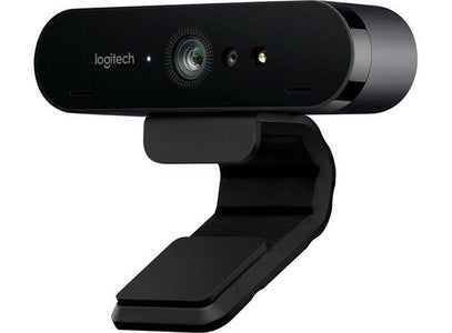

  • Logitech Brio

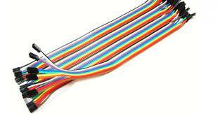

  • Some jumper wires

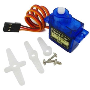

  • Two micro servos with servo horns and its respective screws

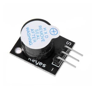

  • A piezo-buzzer (preferably a module to make it easier to mount)
  • Two small screws to fasten the piezo buzzer

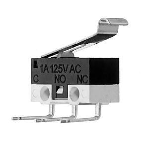

  • One microswitch

  • Pan servo
    • Signal to GPIO 17
    • Ground to any ground pin
    • VCC to any 5V pin
  • Lid servo
    • Signal to GPIO 27
    • If the two servo VCC wires are connected together, this pin will be the same as the one for the pan servo. If you chose to leave out the fan you can connect VCC to any 5V pin
  • Buzzer module with switch
    • Connect one of the outer pins of the switch (any pin but the one in the middle) to a ground pin on the pi (By utilizing the two outer pins of the switch the circuit is completed when the switch is not pressed, resulting in the buzzer making sound whenever the lid/barrier in front of the camera is not fully closed)
    • Connect the other outer pin of the switch to the ground pin of the buzzer module
    • Connect the VCC (+) of the buzzer module to the 3.3V pin of the pi
