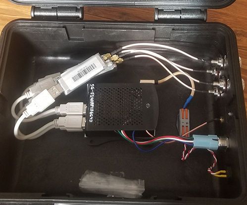

Here I explain how to build one of these devices yourself.

Step 1: Solder 40-pin Header to GPS HAT
GPS HAT purchased from Adafruit typically comes with a 40-pin header that must be soldered to the board.
Instructions on soldering will not be described here.
Step 2: Soldering Pushbutton to GPS HAT
Pushbutton comes with multiple pins – see the specifications for your button to identify each terminal. Plug the pushbutton socket into the pushbutton so you know which wire corresponds with each pin.
Pins are soldered to the GPS HAT in the following order:
  1. Netagive and common switch terminals to ground
  2. Positive to GPIO#17
  3. Normally Open to GPIO#18
Solder the wires of the Pushbutton Socket through the topside of the boards so that the wires come out of the topside.
Double-check you are soldering the wires to the board in the correct order before you start soldering. There may be one wire left unused - you can leave it loose.
Instructions on how to solder will not be outlined here.
Step 3: Assembling GPS HAT
Plug the uFL end of the uFL-to-SMA connector onto the uFL port on the GPS HAT, located adjacent to the square GPS Module and battery slot.
Use a hot glue gun to help fix the uFL connector to the board.
Insert the CR1220 battery into the battery slot, positive (flat) side up.
Step 4: Assembling Raspberry Pi
Plug the GPS HAT on to the Raspberry Pi board using the 40-pin
header.
Install the Raspberry Pi + GPS HAT in the Raspberry Pi Case.
