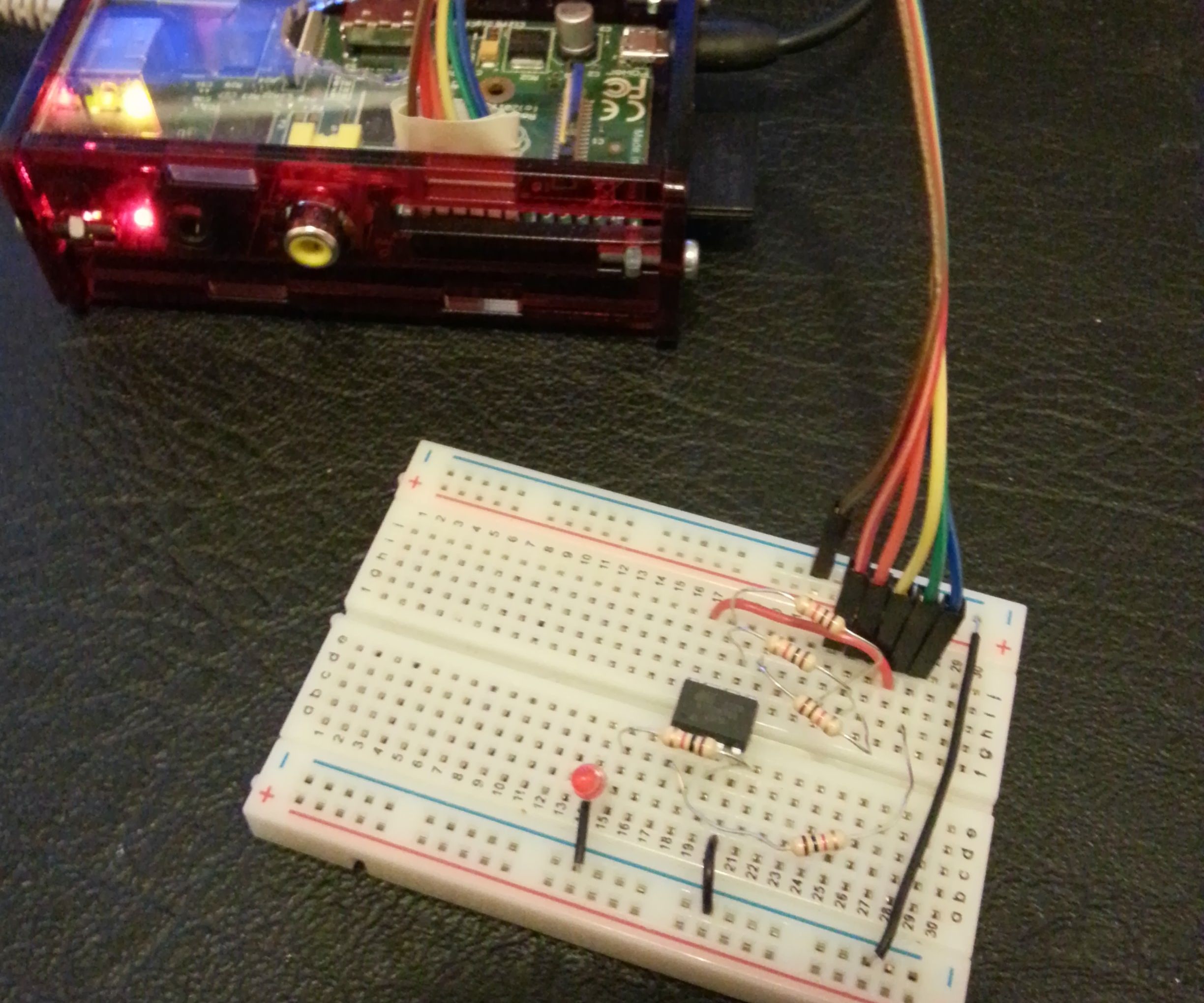

Wiring:
Please see the circuit diagram.
Three GPIO pins are used, for 2 switches (take photo and exit/quit) and one LED.
The take photo switch must be attached to your letter box in some way.
The 2 I2C pins, 3.3V, 5V and ground are taken to the LCD display via the logic level shifter.

Here's the circuit diagram.
