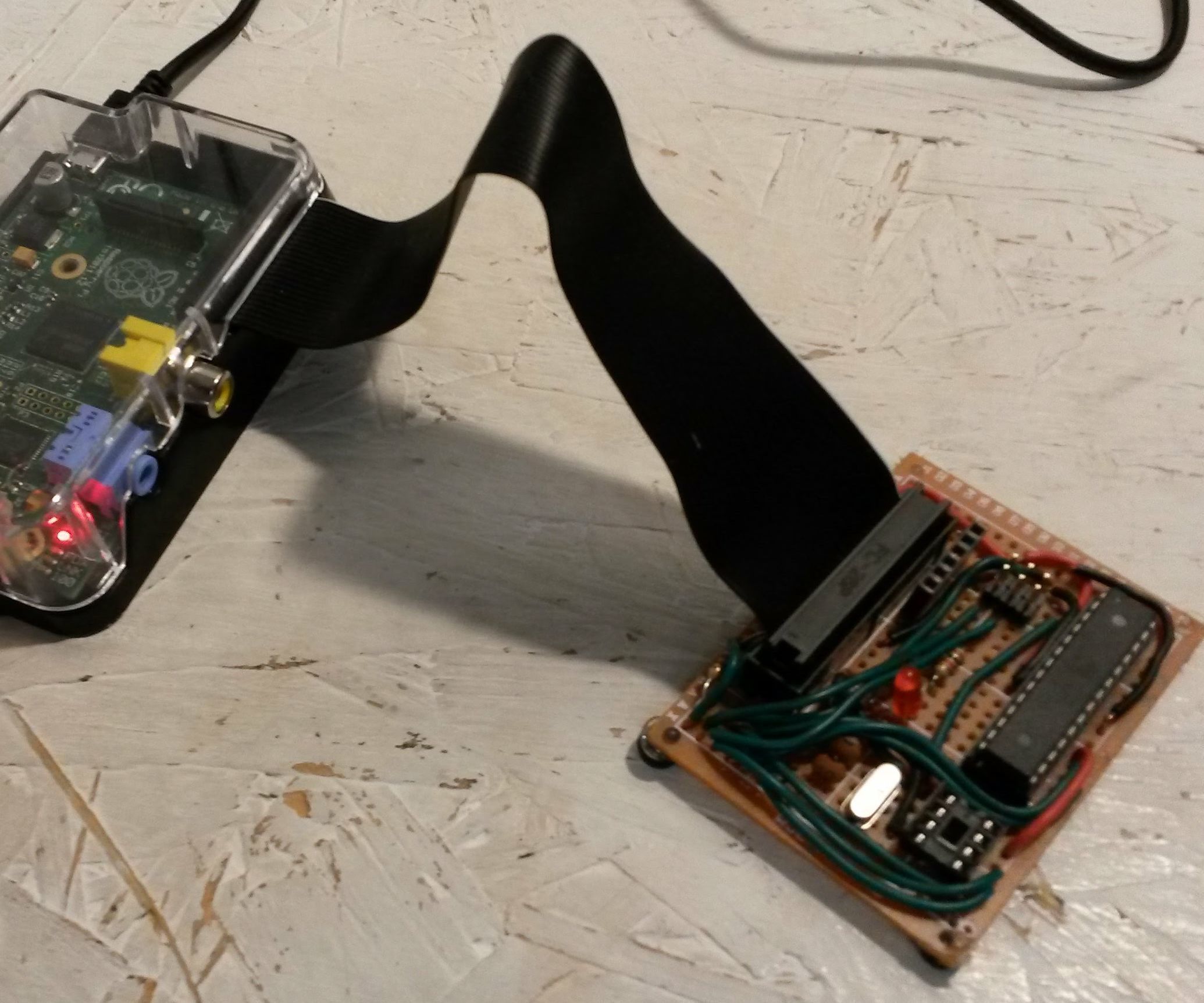

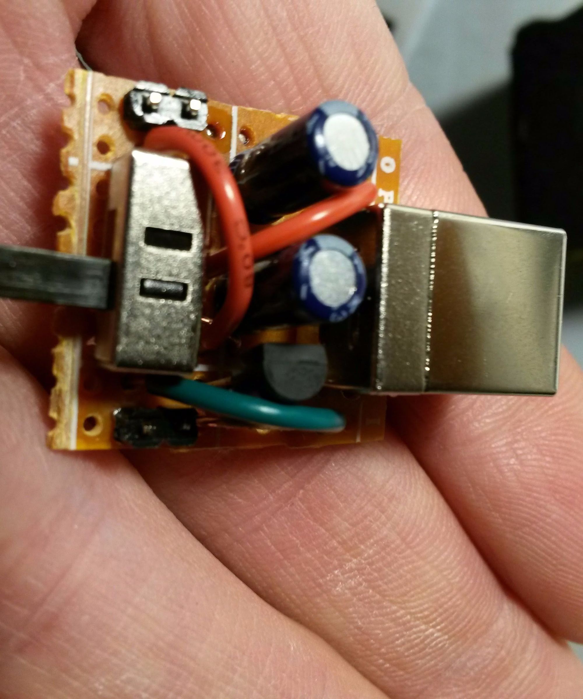

We will connect the LCD and its associated components and the pushbuttons to the Pi Hat. Also, we will add a USB-B and USB-A jack to connect power and a MIDI device, respectively. We bring the USB-A port over because we need to use one of the Pi's USB ports to connect the sound card, which we want to have inside the enclosure, so we cannot have the USB ports flush with the side of the box. I used a USB-B port for power because I felt like it could take more punishment than the Pi's micro-USB power connector, plus I couldn't find a good orientation where the connector could be next to the edge of the box anyway.
You will need to use a knife to cut the traces between the holes where you will solder in the pins for the USB jacks. Just be careful not to cut any of the internal traces in the board connecting the other pins - or if you accidentally do (like me) reconnect them using jumper wire. The USB-B jack's Vcc and GND pins go to 5V and GND on the Pi's expander port, respectively. This way you can power your stompbox with a phone charger (assuming it has enough amperage - 700mA seems to work for me, but you may want more to be sure the USB port has enough juice to power your controller) and a USB A-B cable.
I find that lengths of ribbon cable work really well for connecting things with lots of pins without having too much wire spaghetti. I did this rather than soldering male headers into the LCD and then soldering it into the hat because I felt like I needed some freedom to position the LCD so I could get it centered nicely. The LCD should come with a potentiometer that you use to adjust the constrast - make sure you put this in a spot where it will not be covered by the LCD, so you can make a hole in the box to reach it and adjust the contrast once everything's assembled.
Consult the schematic for details on what gets connected where. Notice that the pushbuttons are connected to 3.3V - not 5V! The GPIO pins are only rated for 3.3V - 5V will damage your CPU. The USB-A jack gets connected to another strip of ribbon cable, which you can then solder to a USB plug which you'll connect to one of the Pi's USB ports for your MIDI controller. Cut any extra metal off the plug so it sticks out less, and use hot glue for strain relief - it doesn't have to be pretty since it will be hidden inside the box.
