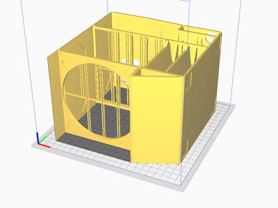

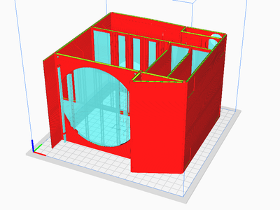

Case: print out of left side: See picture #1
Pi Pan 1-8: print face up with supports: print one for each pi you are adding to the computer: picture #5

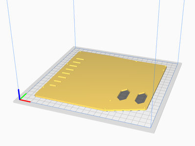

Side Doors: 3d print these unless you are using acrylic doors, then cnc them: Picture #3
