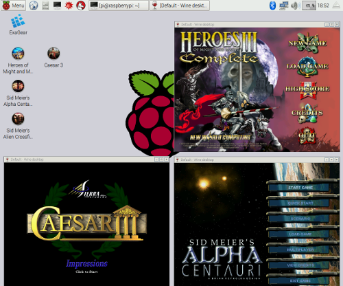

Step 1: Get, Download and Install ExaGear Desktop Software
Unfortunately Teamspeak 3 Server is not available for Raspberry Pi. However, there is a way out, which will allow you to install and run not only TS3 Server, but many other x86 apps and games on your Raspberry Pi. It's called ExaGear Desktop software. You can get it on the corresponding website.
