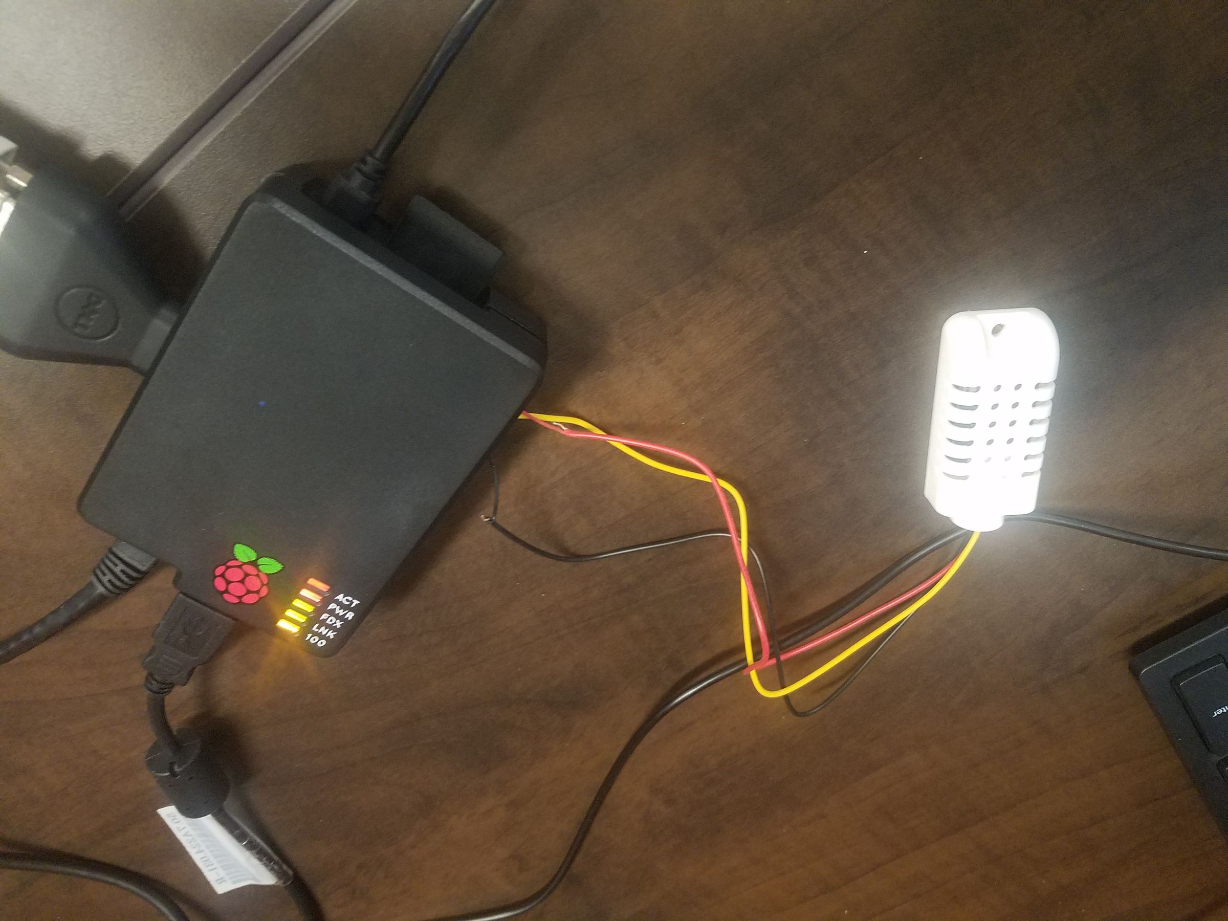

Step 2: Electrical Assembly
The White wire from the sensor is a spare ground, and is not needed. Cut it off inside the sensor case, being careful not to cut any of the other wires.
Braid the other three wires to keep them together, and cut them off about 3.5 inches long.
Prepare a 5-pin single inline female connector (cut from https://www.sparkfun.com/products/115 or equivalent), and solder the wires to it:
1) Red (+3.3V)
2) No Connection
3) No Connection
4) Yellow (Data)
5) Black (Ground)
Plug the connector into the GPIO on the Raspberry Pi so that pin 1 on the connector (red wire) is on pin 1 of the GPIO connector (label P1 on the board, upper right in the picture). Note that the Red wire is on GPIO Pin 1 (+3.3V), the Yellow wire is on GPIO pin 7 (GPIO 4), and the Black wire is on GPIO Pin 9 (Ground).
Tuck the excess wire into the case.
Use a short CAT5 cable (something like http://www.monoprice.com/Product?c_id=102&cp_id=10232&cs_id=1023201&p_id=7505 ) to connect the LAN OUT on the PoE splitter and the Raspberry Pi Ethernet jack. Twist it up to make it stay close to the case.
Take the PoE output cable and a Micro-USB connector or cable and solder them together. If using an AdaFruit http://www.adafruit.com/products/1390 Micro-USB connector, wire it up as shown at http://learn.adafruit.com/assets/12402 , if using a cut-off cable, determine +5 and Gnd wires with a multimeter. Note that the TP-Link wire with the white stripe is POSITIVE.

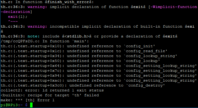

Now copy th.c (included here) into your default directory. Change the password on line 68 from "password" to whatever you chose as the MySQL password.
When you compile it:
make th
you'll get a couple of warnings about declarations of exit, but it'll work fine.

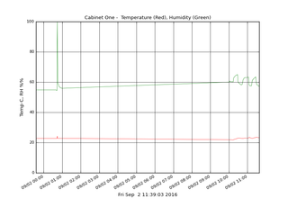

Step 9: Graph Data From the Database
We're going to use Python for pulling readings out of the database and graph them with matplotlib. Log in as root.
Set up the directory structure we'll be using:
mkdir Graph
cd Graph
mkdir graphics
copy GraphTH.py into the Graph directory
Change the password on line 40:
DBconn = mdb.connect('localhost', 'root', 'password', 'Monitoring')
to match the MySQL password you set previously.
You can also set <location_name> on line 81 to match your desired location name

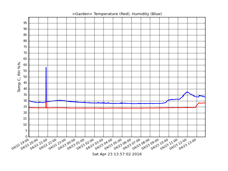

Try running it:
python GraphTH.py
It will get the last 24 hours of readings from the database, reorganize the data, throw out obvious bad data, create a graph of the results, and copy TH.png to /var/www so you should be able to see a new graph time you run GraphTH.py at http://rpithon/TH.png

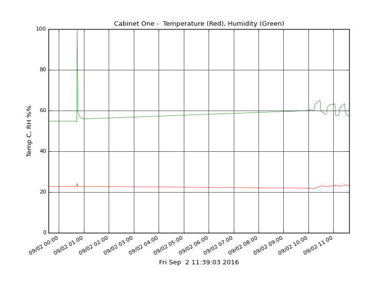

Now we want this to run every minute, so:
export EDITOR=emacs
crontab -e
Add the line:
* * * * * /usr/bin/python /root/Graph/GraphTH.py >> /root/Graph/GraphTH.log
at the bottom of the file.
Now GraphTH.py should run every minute, and if you update http://rpithon/TH.png (or http://<IP ADDRESS>/TH.png you should see it change about once a minute.
In the example above I covered the sensor with a damp Kleenex while it dried as a test.

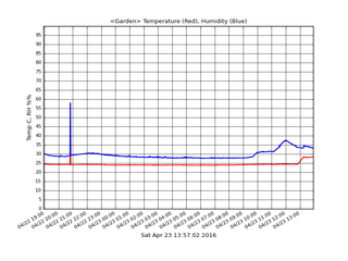

Step 10: Monitor More Than One Location
So I built five of these boxes for various locations, and on the LAMP server of one of them, added the following TH.html

Good question! Sorry for the delay, the answer is well hidden. 8*)
in GraphTh.py after the line:
plt.axis(ymax=100,ymin=0)
add
plt.yticks(numpy.arange(start=0,stop=100,step=10))

I'm at the "make th" step too, but get this attached error. Any thoughts? Trying to make the th.py above looked way worse. The python ez_setup is non-existant, so maybe that's what I'm missing... Is there an alternative to that?
Thanks for coming back to reply to these posts once in a while. Though dated, between comments and Google I've gotten this far, and even have the RTSP camera server running on my Pi, so it's not totally useless :)
Edit: I included the stdlib.h library, but still get the "recipe for target th failed" error.
