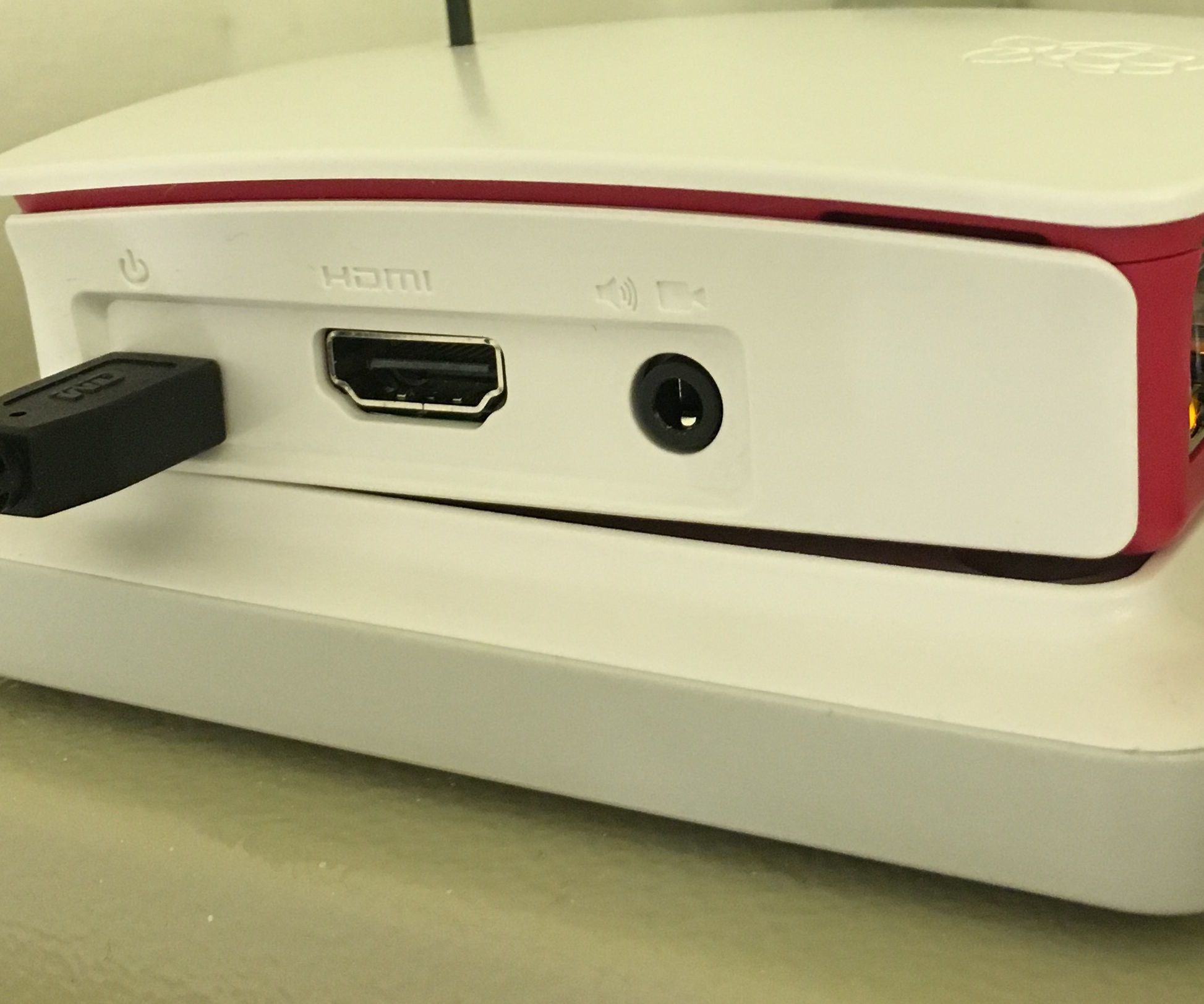

Step 1: Install Hardware on the Pi
The first thing to do is to install the radio receiver (Ciseco Slice of Radio) on the Raspberry Pi.
See the Photos.
