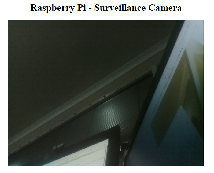

Step 7: Final Test
To see the streaming follow the next steps:
- Open a browser
- Type your public IP follow by the external/public port (http://Your public IP:9090/stream)
