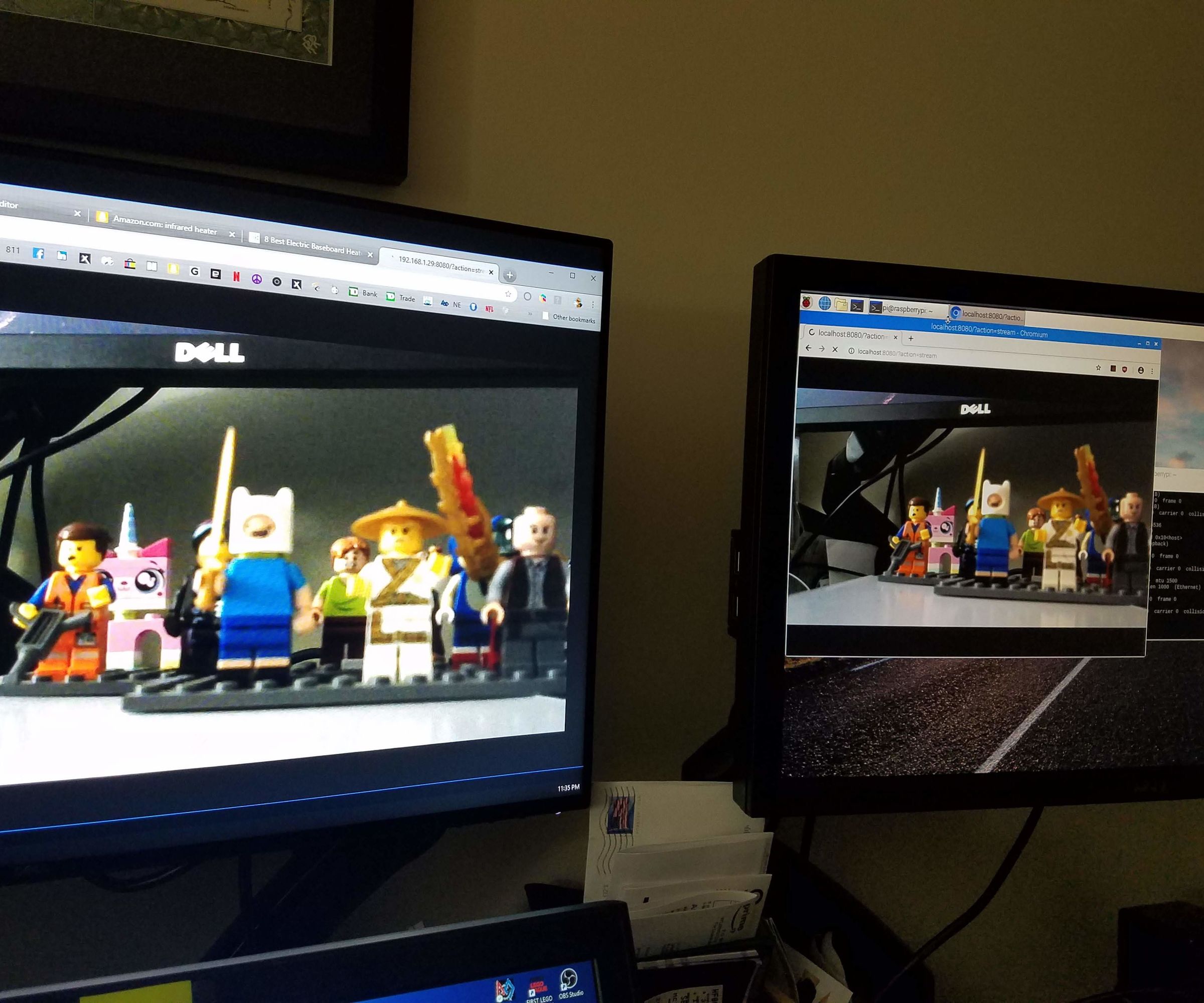

What is missing are Logitech C920 cameras. These will all stream H.264 natively. Each Raspberry Pi is running from started a streaming source. I can't remember the package being executed, which is why Part 2 will handle the SW side.

OBS Studio will now allow you to manage the output of each of the cameras. You can create multiple scenes. Either 1 camera per scene, or create a quad image of all camaras in its own scene.
