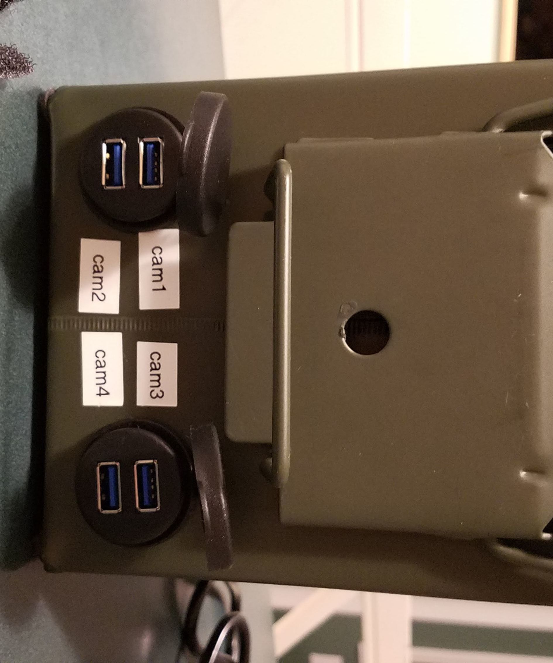

I use the cameras to provide multiple points of view of a FIRST LEGO League competition. I've also put together a 4 camera kit for my children's high school to allow the streaming of events (concerts, graduations, etc) to Facebook. I've also tested with Twitch and Youtube. OBS Studio provides multiple options
There is no real limit to the number of cameras, other than bandwidth. I prefer to use hard lines, as it preserves the bandwidth better. Wireless has latency issues, especially in a crowded signal environment with lots of metal (discovered this during a dry run at a school fund raiser).

- (4 qty) Logitech C920 USB camera <=> RPi
- Each RPi is attached to an unmanaged switch.
- A laptop with OBS Studio is also attached to the switch.
- All of these ports were setup to my own personal IP address configuration.
