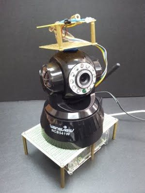

Introduction: Raspberry Pi + WebCam + IR Remote Home Controller
Harware :
1. HomeWebCam
2. IR Remote Control
3. Raspberry Pi
How to Make ?
See Above Photos
How it works ?
- Use your Home WemCam Software to control and View.
- When the Laser Pointer point to Device, Remote to ON and Off by WebIOPi
More Information : iMediaBank - http://www.imediabank.com

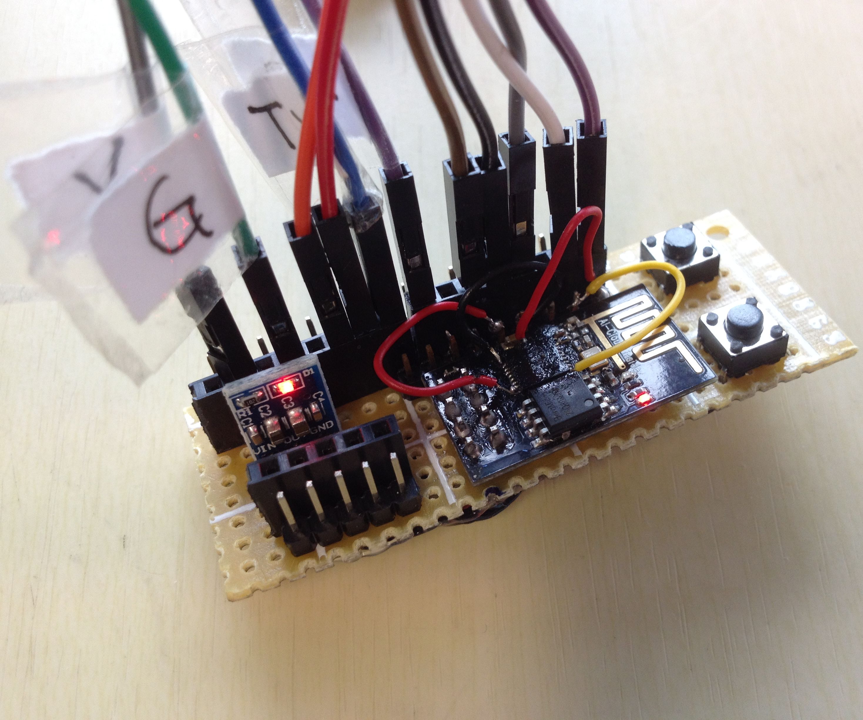

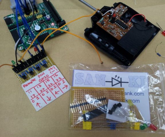

Step 1:
IR Remote
Hardware
Parts
- Infrared LED: Home TV remote
- IR Receiver: A3H3 and A3I3
- NPN Transistor: B29X 9014
- 1.5Ω Resistor: 1
- 220Ω Resistor: 1
Terminal Install :

Create a new remote map
Check Key List name $ irrecord --list-namespace
# Stop lircd so /dev/lirc0 is not in use sudo /etc/init.d/lirc stop
# Create a new remote control configuration file (using /dev/lirc0) and save the output to ~/lircd.conf irrecord -d /dev/lirc0 ~/lircd.conf
# Edit ~/lircd.conf and add edit the name of the controlled device nano ~/lircd.conf
# Make a backup of the original lircd.conf file sudo mv /etc/lirc/lircd.conf /etc/lirc/lircd_original.conf
# Copy over your new configuration file sudo cp ~/lircd.conf /etc/lirc/lircd.conf
# Start up lirc again sudo /etc/init.d/lirc start TEST # List all of the commands that LIRC knows for 'samsung_tv' irsend LIST samsung_tv ""
# Send the KEY_POWER command once irsend SEND_ONCE samsung_tv KEY_POWER
# Send the KEY_VOLUMEDOWN command once irsend SEND_ONCE samsung_tv KEY_VOLUMEDOWN
# Send the KEY_VOLUMEDOWN command 10 times lowering the volume for 10 units at once irsend --count=10 samsung_tv KEY_VOLUMEDOWN
