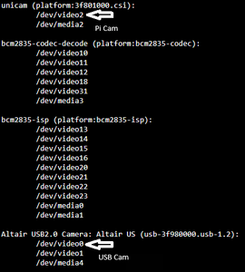

  1. Before configuring, check your camera sources by running the following command:
v4l2-ctl --list-devices
  1. Make note of the one(s) you plan to use. Note the first line under your video source (usually something like /dev/video0)
  2. USB Cams are listed under the device name. If you are unsure of the device name, hook the camera up to your PC or Mac to get the name.
  3. Pi cam should be listed under something like unicam.
  4. See the image attached for example.
  5. You will have to have a separate configuration for each camera. Go to Step 4 to find instructions for doing this.
