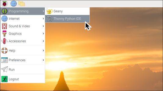

Thonny comes pre-installed on Raspberry Pi OS, you will use it in this section to write some code against your Phidgets!
  1. Open Thonny by navigating to Programming > Thonny

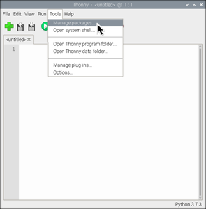

  3. Click on Tools > Manage packages
  4. Search for Phidget22 and press Install
