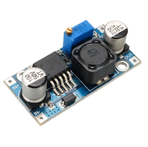

3) DC to DC converter (LM2596 is a good one)

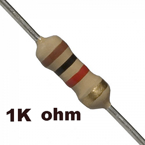

4) 1K Resistor

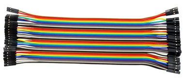

7) Wires with female Dupont connectors

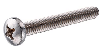

8) 4-40 x 1" screws and nuts (or longer)

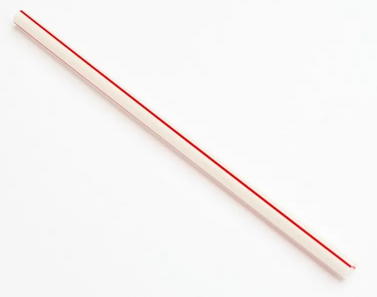

9) A plastic drinking straw.
HINT: The longer the 4-40 screws are, the easier it is to thread the nuts on. They stick up higher.

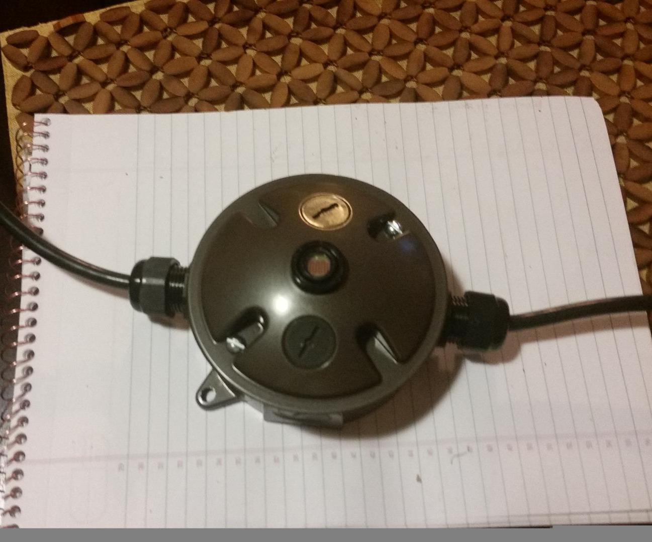

Step 1:
1) Take a metal electrical box and-
a) with a nibbler, nibble an opening for the USB and ethernet ports.
b) Drill mounting holes for the RPi and DC to DC converter. (big enough to fit a 4-40 screw)
c) Drill a mounting hole for the DC barrel connector.
d) Knock out the 3/4" knock-out for the motion sensor. HINT: Most of the knock-outs will be 1/2", the 3/4" will be the bigger one.
Step 2:

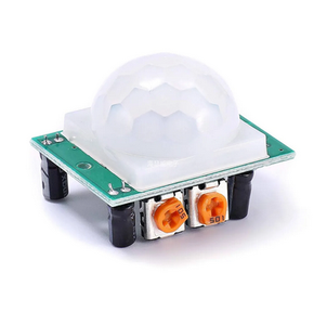

2) Plug three Female to female Dupont connector hook-up wires to the +5V (red), GND (black), and OUT (any color you want).
Glue the motion sensor into the 3/4" hole with silicone. Glue in with the wires down and the two adjustment pots up.
***LET DRY before proceeding!***
Step 3:
3) Cut a straw into small sections to act as spacers to keep the RPI and DCtoDC from touching the metal box.
Step 4:
4) Using 4-40 1" screws, mount the RPi in the box with the straw sections acting as stand-offs.
Step 5:
5) Solder wires onto the DC barrel connector and mount it.
Step 6:
6) Solder the wires from the DC connector to the inputs of the DC to DC converter.
Step 7:
7) Cut one end off of two Dupont connector hook up wires (red and black). Leave a connector at the other end.
a) Solder the end of the red wire to the OUT+ pad on the DCtoDC module.
b) Solder the end of the black wire to the OUT- pad on the DCtoDC module.
c) Apply 12V to the barrel connector and set the DC to DC module for 5.1V with a volt meter.
d) Mount the DC to DC module in the box with 4-40 screws and straw stand-offs.
e) Plug the red wire into the RPI Pin 2 (+5V)
f) Plug the black wire into RPI Pin 6 (GND)
Step 8:
8) Connect the three wires from the motion sensor to the RPi as follows:
MS +5V ---> RPi pin 4 (+5V)
MS OUT ---> 1K Resistor ---> RPi Pin 29 (GPIO5)
MS GND ---> RPi Pin 30 (GND)
NOTE: The 1K resistor is needed because the GPIO input is 3.3V but the IR module's output is 5V. It's not the perfect solution but, it works.
