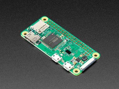

In this project, I will show how I made a dashboard using an old Pi Zero W and Dakboard.
Pi Zero W

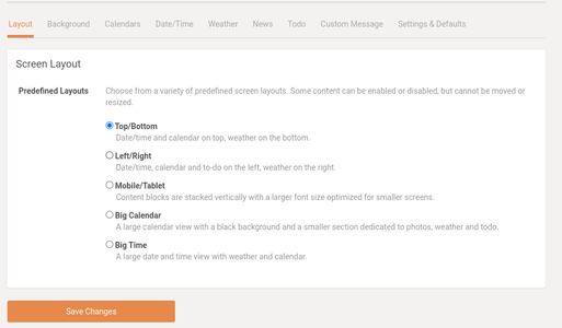

Step 2: DAKboard Setup
  1. Go to dakboard.com
  2. Make an account
  3. Choose a plan(Free gives you a predefined screen, Essential and above allow you to customize it.)
  4. Go to your screens and start editing either Predefined or Custom if you paid
  5. Once done, find the private URL and save it.
