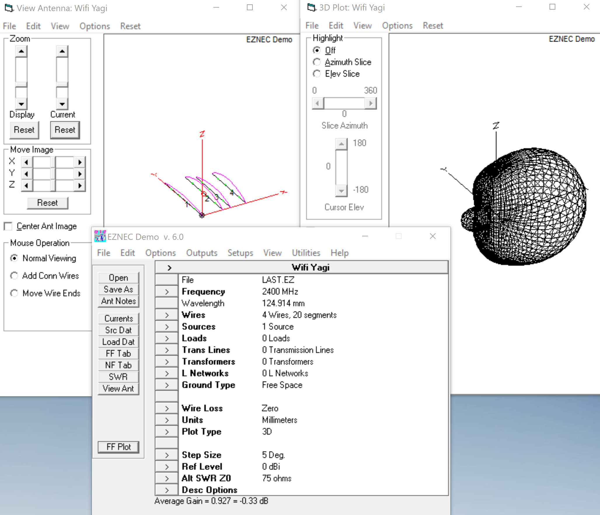

We wanted a directional antenna that works at wifi frequencies. The Instructable we started with includes a detailed pattern for a directional Yagi antenna which can be made out of paperclips and popsicle sticks. We made only one modification. This antenna is 42 cm long and contains 15 conductive elements. We got rid of all but four of the elements so the antenna will be shorter.
Next, we simulated the antenna to ensure that it was still directional, even with fewer elements. EZNECby Roy Lewallen is an easy to use antenna simulation tool. We used the demo version of EZNEC 6.0. The first step to using this software is to describe the antenna. Click on the Wires button, and enter the location of the antenna elements. The size and location of these elements are detailed in the antenna pattern. Next, we set the frequency to 2.4 GHz for wifi signals, and we chose the ground type to be free space. The EZNEC file describing the antenna, WifiYagi.ez, is attached.
The output of the EZNEC simulation is shown below, and it verifies that the modified antenna is still directional. The left part of the figure shows the antenna. The black lines are the conductive elements, and the red circle on the second element is where the the wifi adapter connects. The right part of the figure is the 3D radiation pattern plot. The figure shows the relative strength of the signal at a fixed distance from a transmitting antenna at different angles. Since the plot is larger in x direction than in other directions, the antenna is directional. Most of the energy transmitted by the antenna will go in the x direction. If we orient this antenna properly, and assuming all else is equal, this antenna should be able to communicate over longer distances in the x direction than if we had not used a directional antenna.

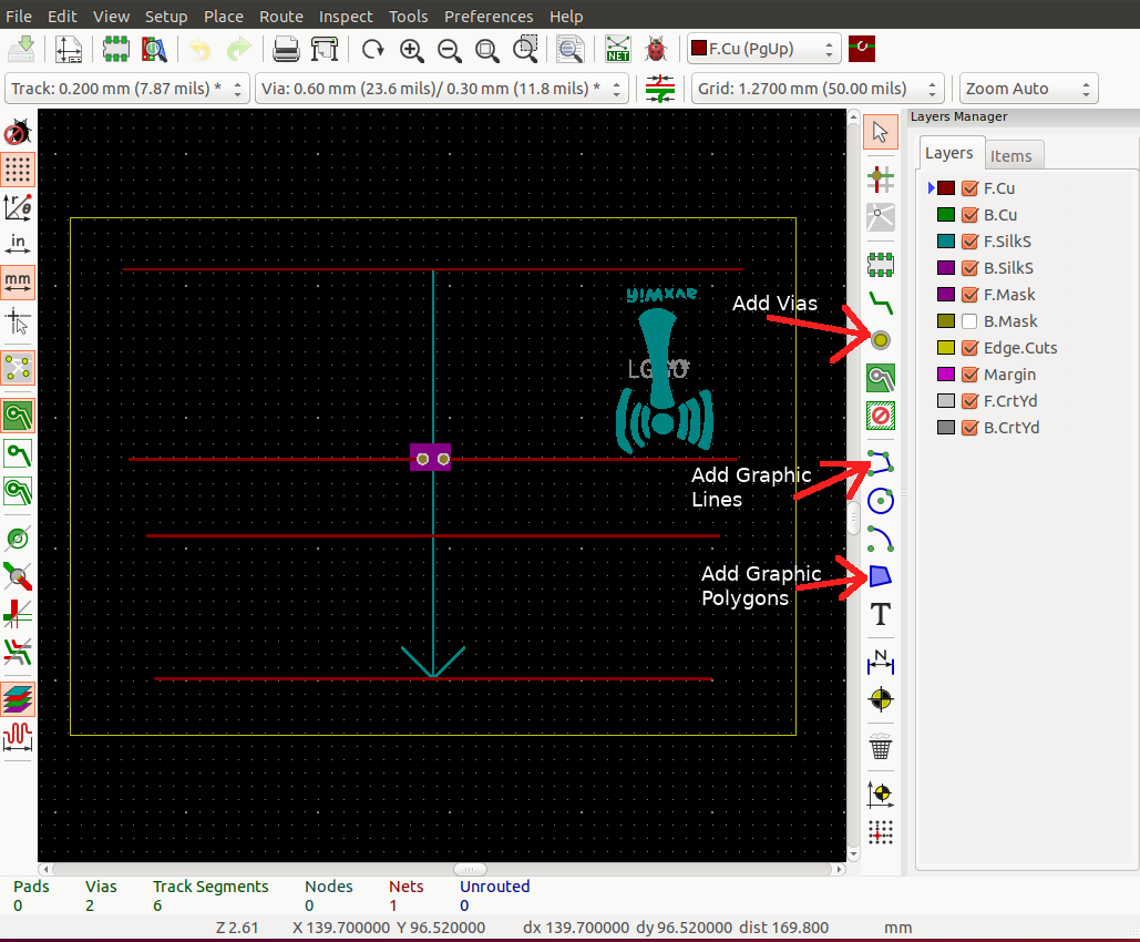

The next step is to lay out the custom PCB. While the antenna pattern we started with is easy to construct, it is difficult to construct precisely. Printed circuit boards are manufactured more accurately, and they are more durable. We used the open source program KiCad. Our PCB layout files are attached, in wifi_pcb.tar.gz. To unzip the file, use the command:
tar -zxvf wifi_pcb.tar.gz
The steps to laying out the PCB are to:
- Open a new KiCad project.
- Go to the PCB Layout Editor.
- Select the Add Graphic Lines button and the Edge.Cuts layer, and define the perimeter of the PCB.
- Select the Add Graphic Lines button and the F.Cu layer, and draw the antenna elements in the front copper layer.
- Select the Add Vias button, and insert two holes where the wifi adapter will be connected.
- Select the Add Graphic Polygon button and the F. Mask layer, and draw a hole in the front solder mask so it won't cover the via holes. Repeat using the B.Mask layer to draw a hole in the back solder mask too.
- Add any additional marks or labels desired to the silkscreen layers.
- Select File then Plot to generate Gerber files.
