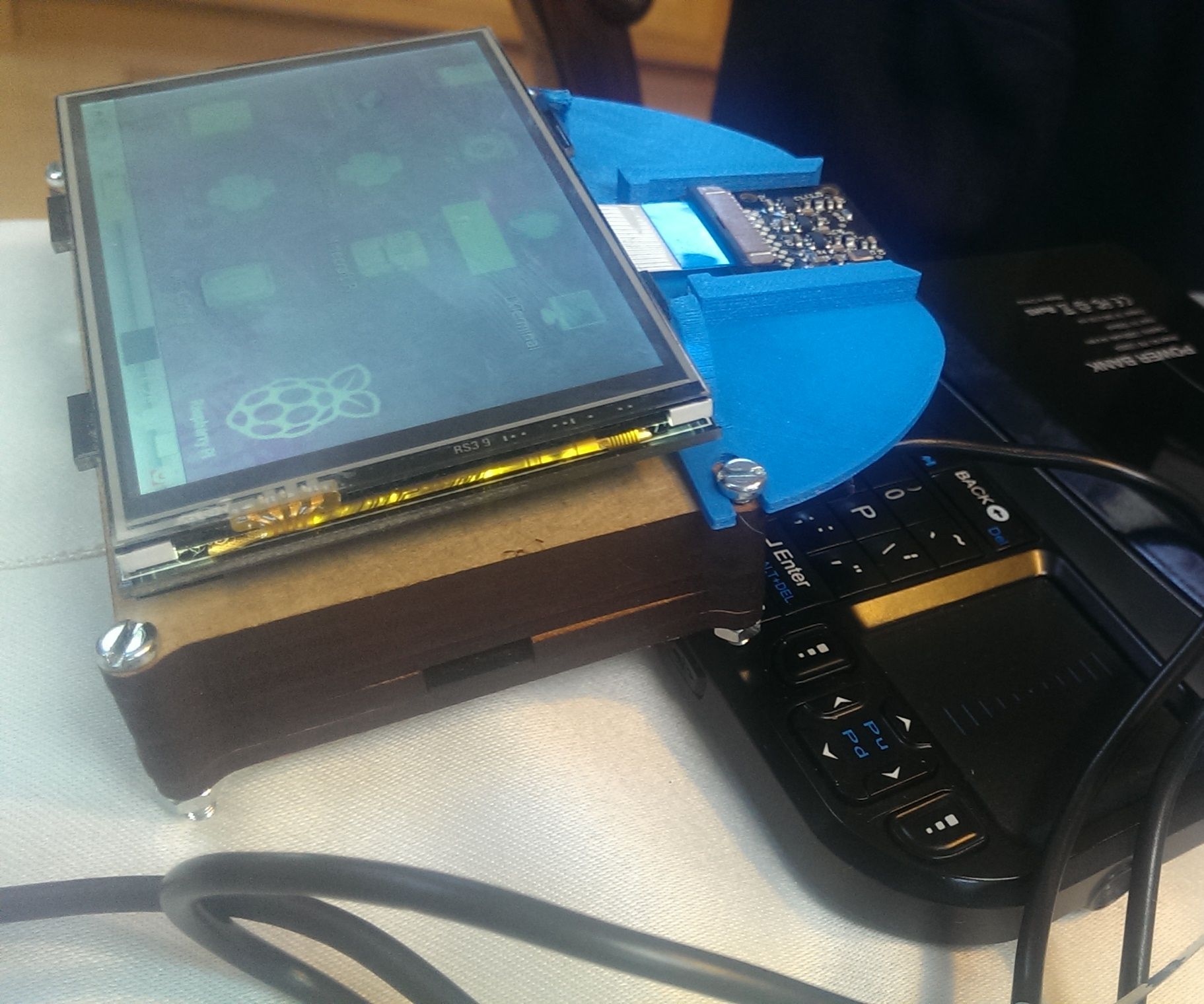

Introduction: Raspberry Pi Based Wall Avoiding Robot - FabLab NerveCentre
______________________________________________________________________________
Please note: This instructable is not complete - but may be helpful
Published to allow the excellent people at Derry's NerveCentre to take the code out to schools
I hope to get back to this but my current job is keeping me from it for now.
This instructable is an alternative to my other wall avoiding robot found here:
https://www.instructables.com/id/Arduino-wall-avoid...
The intention is to offer an alternative platform and coding in order to achieve the same result.
For this project we use the Raspberry Pi and the familiar L293D dual h-bridge chip. The ultrasonic sensor is the widely used HC-SR04.
The coding is done in Python, which I find to be considerably easier to interpret for those who haven't done a lot of coding.
Enjoy the project and please give any feedback you can so that any necessary improvements can be made.
