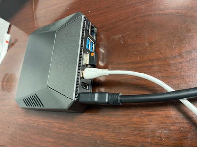

Step 2: Connect the Screen and Turn on the Pi
Once you have Raspberry Pi OS installed, it's time to plug in our peripherals. Connect the screen to the Pi and plug in the power adapter.

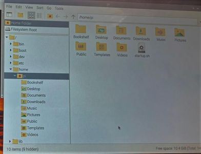

Step 4: Create a Custom Bootup Script
Next, we'll tell the Pi to open Chromium to the Google Calendar page every time it's powered on.
To accomplish this, we will create a startup script that launches everything for us.
Create the startup script You can use any text editor you like, I'll be using Notepad++.
Create a file with the following script.
Note: Chromium has trouble rendering the Calendar properly, this is resolved by running Chromium with a different user agent.
You don’t need to do anything extra for this, I included the user agent information in the script below.
Feel free to experiment with other user agents.
chromium-browser https://calendar.google.com --user-agent="Mozilla/5.0 (Windows; U; Windows NT 6.1; rv:2.2) Gecko/20110201" --disable-infobars --disable-session-crashed-bubble --kiosk &
Enter a filename like startup and save it with a .shfile extension. Drop the file in the /home/pi/ directory.
Edit the autostart file Now we need to tell the Pi to use our new script when it turns on. We'll do this by editing the autostart file. Connect to the Pi using a terminal, like PuTTY, and run the following command.
sudo nano ~/.config/lxsession/LXDE-pi/autostart
At the bottom of the file, include the following string. Be sure to replace startup.sh with the filename you chose.
@sh /home/pi/startup.sh
Save the file using ctrl+x, press y, then enter.
