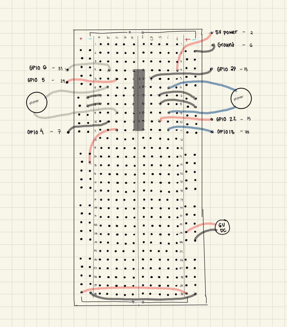

Step 1: Designing the Circuit
I had a lot of trial and error with creating the circuit learning from basic lighting an LED and running motor circuit tutorials online and connecting it with a Raspberry Pi 5. I studied how the motor controller worked by connecting it to buttons and testing the motors. Finally, I shifted the wires connected to the buttons to the Raspberry Pi pins and used a simple python program to test it.
Step 2: Final Circuit Design
The diagram above was my final circuit design. I completed this portion by soldering the components together onto a circuit board.

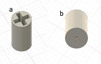

Step 3: Designing the Base
My robot's build was visibly inspired by Wall-E. In the bottom there was the (1) chassis to hold the motors and the axles, an (2) upper shelf that slides out to hold the circuit components, and (3) detachable eyes to sit the camera on. This was designed to utilize gears and treads so I designed a small piece to attach the (a)axle to the (b)motor.
