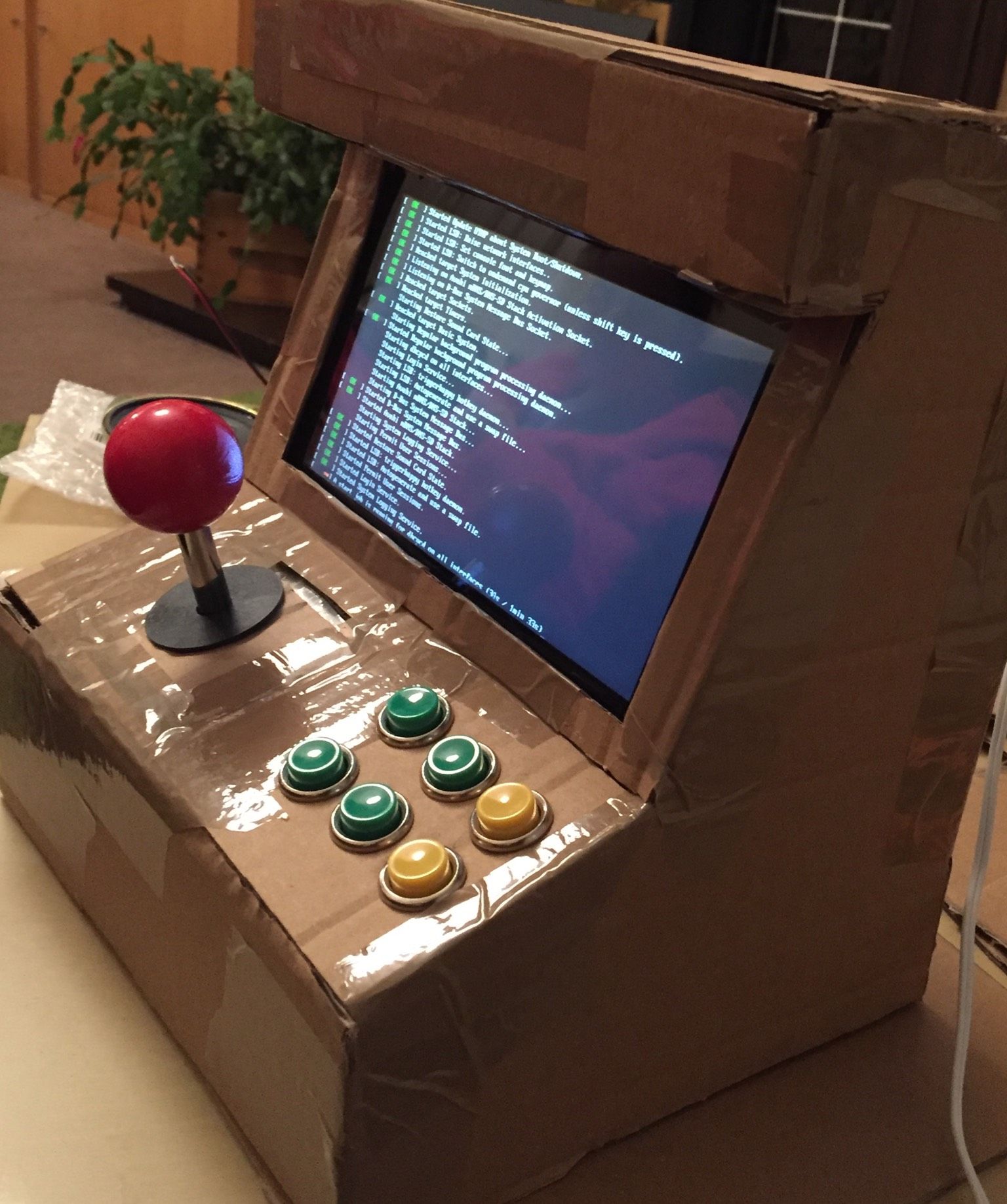

After the success of my first Instructible here's my second one! It's not a million miles away from the arcade machine I built but the arcade machine is only a one player machine and it's only a got small one person screen.
So this build is going to be a retro games console with an entertainment add on, most likely in the form of kodi. There is going to be 2 player support and hdmi connection to a bigger screen, and the twist is its going to be built into a retro console!
