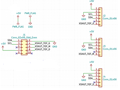

The schematic (second picture) is very easy. Each time-of-flight sensor (VL53L1X) communicates with the motherboard with the I²C protocol (SCl and SDA lines). Sensors are powered with 5V and GND from the motherboard. Our robot has a 4S Lipo Battery (14.8V) so we create the 5V needed thanks to the D24V50F5 (Pololu Voltage Regulator). The X shut lines allow to shut down the sensors. We use these lines during the starting sequence of the robot to give a different I²C address to each sensor. This feature is handled by the hub board and the motherboard (not described here).
Once the schematic is done, we place the connectors, and we trace the routes. We also put two mounting holes. We simply used a two layers PCB. The bottom layer is used to make a ground plan. Don’t forget to put silk-screen printing on your board!

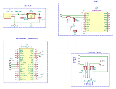

This PCB allows us to control our robot with an old PS2 controller. When a button is pushed on the controller, the Arduino micro plugged on the PCB reads the input and sends the data to an XBee module. Another XBee is plugged on the motherboard of each robot. When a command is received the robot executes the corresponding action (move forward, rotate, …).
follow this link to find a tutorial that will give you the basics of the system: https://electropeak.com/learn/tutorial-interface-wireless-playstation-ps2-controller-arduino/. You can find the schematic and the PCB design in the picture above.
The inputs from the PS2 controller are connected to pins of the Arduino micro according to the schematic. The device is powered by a 3S Lipo battery, therefore we used a linear voltage regulator to lower the voltage to 9V. Data are sent to the x bee through RX and TX pin. Since the Arduino and the XBee have different logic levels (5V and 3.3v), we used resistors to convert voltages. Note that the reset pin is pulled High.
