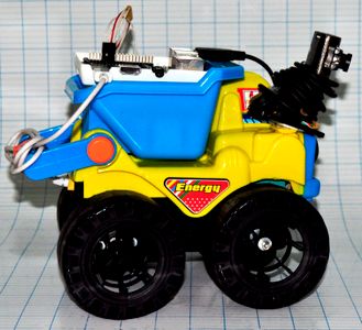

Step 3: Install Battery
Prepare 2 type of batter for car.
(1) Power bank (black one in picture): choose type 5VDC 10A for Raspberry. As test, it can feed Raspberry more than 8 hours!
(2) Power bank (blue one in picture): this power is used for H-Bridge circuit L298N
It should be used 2 kind of power for safety operation of Rasbperry and motor
After that, install battery in car. Power bank for Rasp is put inside of car, whereas batter for motor is put on car
Step 4: Connect All Together
Now, put Raspberry in car.
