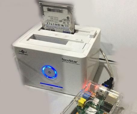

Step 1: Using a USB External Hard Drive With Your Raspberry Pi
In many cases SD capacity is not enough. Luckily
Raspberry Pi can easily be connected to external USB hard drives. Follow the steps in this section, and you will soon have a lot more storage connected to your Raspberry Pi.

Please connect your USB external hard drive to the Raspberry Pi and make sure that is powered by an external power source.
