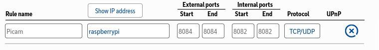

  1. You will need to set up a rule in router's configuration to direct any requests through the internet to your Raspberry. An example for the BT SmartHub is shown in the image at the top of this section. Other routers will likely have the appropriate settings under Firewall or Network Allocation Table settings. Decide on an external port number that you will need later to access the server. In this example I'm using 8084.
  2. Find out your router's IP address (you can visit whatsmyip.org, for example). If your broadband connection changes occasionally, you might want to consider setting up a dynamic DNS server, so you can access your home network externally, even if the IP has changed (noIP for example).
  3. You can access the video stream externally through your router's IP address plus the external port number (see step 1) that you have set up in your router, e.g. open your browser at 109.159.2.111:8084
