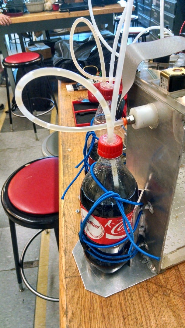

This bartender uses pressurized bottles and solenoid valves controlled by a raspberry pi to dispense the beverages. The user can interact with the GUI on the pi to select their drink of choice, they will be prompted to add any required garnish, then they can put their cup under the spigot, and the correct mix of drinks and mixers will be dispensed into the cup.

When you build the enclosure, it can be as big or small as you need it to be. We made one large enough to hold five bottles. It is a five sided sort of half circle, with a bottle strapped to the outside of each side using bungee cord to hold the bottles tight to a v-channel. You should also put a cap on the top to mount all of the electronics, valves and hoses, and a spill tray on the bottom.

They are not food rated, so we probably shouldn't have used them. They were just super cheap. We did make food grade adapters to make the pipe thread small enough for the push connect fittings... which are also not food grade.
The tubing leading into and out of the bottles and valves is food grade, which is good! And zip tying the hoses together keeps them rigid enough to act as a spigot.
