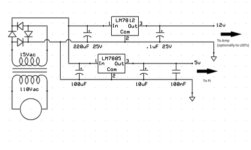

Step 2: Building Circuit/wiring
The regulation circuit is pretty simple and self explanatory, just watch your polarity on those caps!
Solder the leads from your 8 ohm speakers together (unless you want stereo, which i didn't feel was necessary for this project, and would require more parts/steps) then directly onto the Velleman amplifier as shown in diagram. Solder the micro usb gnd(black) to the gnd of your 5V supply, and the VCC(red) to the supply 5V+. Splice Aux cable and tie the two channels together and solder to the potentiometer (see diagram) solder leads between amp and potentiometer as seen in diagram. Finally, attach power to amp as seen in diagram.
My monitor came with the power leads pre-spliced and tinned, though if yours does not, make sure that your polarity is correct (red+,blk-). Solder monitor to 12v supply.
Connect amp to pi via the aux cable. Connect monitor to pi via RCA. Connect power to pi via micro usb.
Put it all together and boot your pi.
