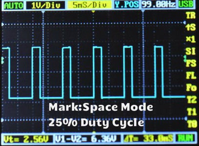

Traditional PWM uses Mark:Space mode.
The time the voltage is high is varied. (Modulated)

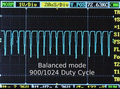

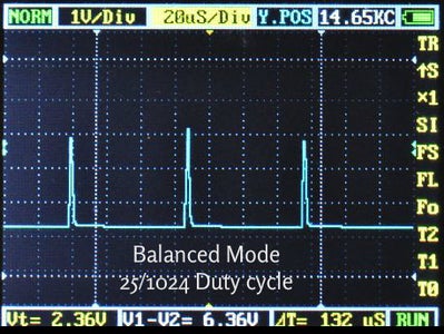

But the RaspberryPi uses balanced mode PWM as it's default.
Balanced mode PWM looks like this:
_ _ _ _ _ _ _ _
___ ___ ___ ___ ___ ___ ___ ___
<------------------------------> 25% duty cycle
_ _ _ _ _ _ _ _ _ _ _ _ _ _ _ _
<------------------------------> 50% duty cycle
Instead of Modulating the pulse width it actually modulates
the pulse count and spaces it evenly across each base cycle.
The maximum pulse count is refered to as the range or
resolution. The default range is 1024.

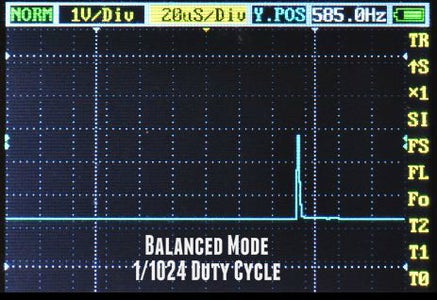

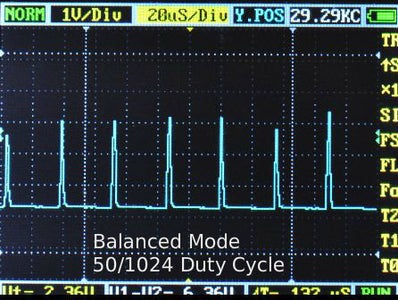

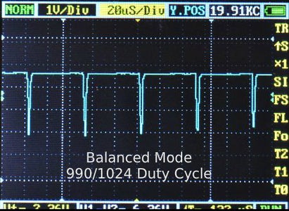

Step 5: Producing Tones With PWM in Balanced Mode
Sometimes you may want to use PWM to create a tone, and sometimes you may wish to stop the noise from going to the speakers.
In balanced mode the duty cycle will control the frequency of the noise. Up to half of the range clock times range will give you the frequency of the tone. Above half the frequency of the tone will decrease by the base frequency with each step. At maximum range the frequency will be zero.
With the default range and clock settings A duty cycle of zero will be quiet. One will play a 585 Hz tone. A duty cycle of 512 will produce a 299.52 KHz tone, well above the range of human hearing. At 1023 the frequency will be back down to 585 Hz, and at 1024 it will be silent again.
At higher frequencies the tone you are hearing is noise, this noise will be heard on the speaker and it is also on the PWM pin. You can minimize the noise in the speakers by setting the clock to a lower number. This causes more of the noise to be out of the range of human hearing, but it does not change the noise on the PWM pin. You can eliminate the noise in the audio by re-routing the sound to HDMI in raspi-config.
If you Set the range to 64000 and the clock to 300 the duty cycle will equal the frequency up until the point where the harmonic becomes audible.
Step 6: Producing Tones With PWM in Mark:Space Mode
Make sure you turn the volume down before you try making tones using Mark:Space mode. It can get very loud. I believe this is the reason the RaspberryPi uses balanced mode as it's default.
In Mark:Space mode the frequency is the base PWM frequency and it is controlled by the clock. The default clock of 32 will give you a 585Hz tone. The base frequency is inversely proportional to the clock. Increasing the clock will give you a lower tone and vice-versa.
The volume is controlled by the duty cycle. As the duty cycle is raised the volume will increase until half the range, then it will decrease until at maximum range it will be silent.

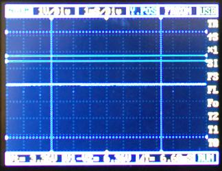

Step 7: Digital to Analog Convertor
Balanced mode PWM has another use besides making tones. The higher frequencies make for less ripple when you add a capacitor to create a digital to analog converter.
Plug the capacitor into the breadboard. The negative lead, the shorter lead, goes to the ground rail.
The other lead goes to the positive rail.
Now run the PWMdemo program. Make sure PWM mode is set to Balanced, Range=1024, Clock=32.
Use the fade option number one, the oscilloscope will show a horizontal line move up as the voltage increases and then back down again. Figure one shows very little ripple.
If you have a multimeter attached use it to check voltage. You will see the voltage rise and then fall.
Turn the speakers off and change the mode to Mark:Space, you should see more ripple as illustrated in figure two.

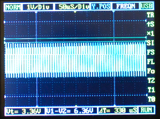

Step 8: Look at the Noise
The first image shows the noise running through the PWM signal.
Lowering the frequency on the oscilloscope some more and it shows just the noise. A capacitor charging and dis-charging.
