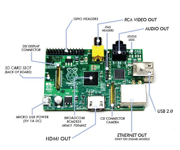

Introduction: Raspbery Pi Wireless Auto-Sorting NAS/Media Server Using MiniDLNA and Samba
I have a couple of spare USB hard drives lying around, and of course a Raspberry Pi (headless). I put them to use as a wireless NAS / Media server. I'd also like my clients to be able to make the Pi automatically download torrents and save them on the NAS. I've already posted a guide to set up your Pi as a wireless access point. Just ignore the bit about 3g if it's not relevant!
To do this, I'll use Samba to share the files over my network (a mixture of Linux and Windows clients), and MiniDLNA to manage media serving. MiniDLNA will allow any UPnP compatible device on your network, such as a television or games console, to access the shares on your Pi. qBittorent will be used as the torrent client. Fsniper will be used for auto-download feature..
I also use fsniper to automatically sort all locally downloaded content into the appropriate files on the NAS.
As an alternative to this, you could use an operating system like FreeNAS or XMBC. I prefer to keep Raspbian and bolt on the extra bits I need.
This guide assumes you are using the 06-12-12 of Raspbian. It should also work on the latest version, but I can't guarantee that as I've not had chance to test it yet. I used the following IP scheme:
Pi Ethernet Port: 192.168.1.10/24
Pi wlan0: 10.0.0.1/24
Note: external hard drives on the Pi should be connected via a powered hub.
