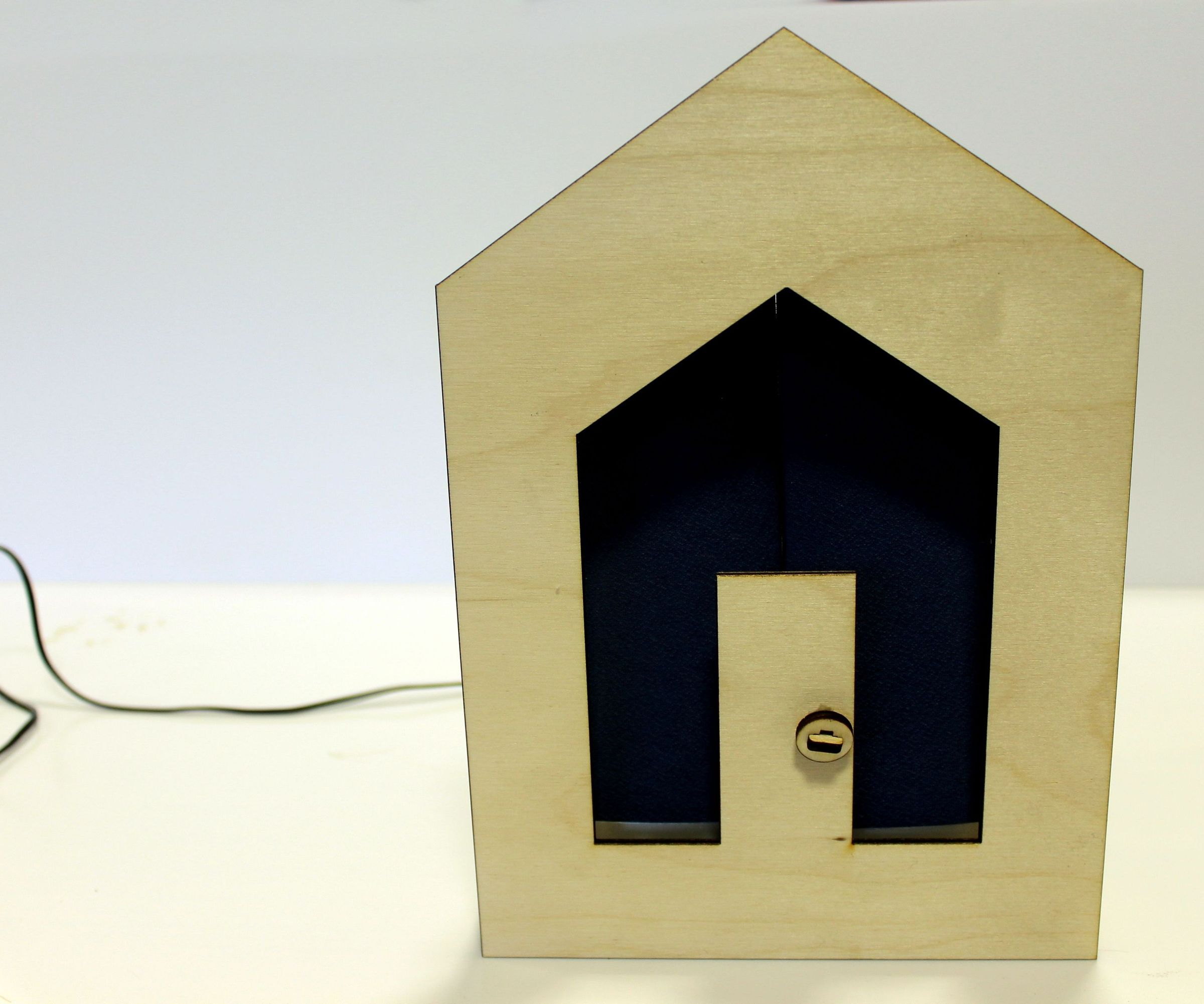

Step 10: 3D Print and Assemble!
Open the stl files & print them. If you're using different components, make sure to change their dimensions!
Then assemble, plug-in and play!
