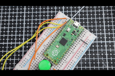

Step 1: Circuit - Simple Version
Above the schematic is included for all the necessary connections that needs to be made to the Pico. You can use any of the GPIO pins but for demonstration purpose, GP0-3 will be used to connect 4 buttons. The buttons is connected to the + Voltage rail which is 3.3V power by the Pico's 3V3 output.
We will test for a HIGH input from our GPIO pins. The buttons will be pulled down to ground by internal pull-down resistors and be LOW, and when a button is pressed the 3V3 will be detected by the pin and set to HIGH and trigger an event.
All this will be explained in the coding section
