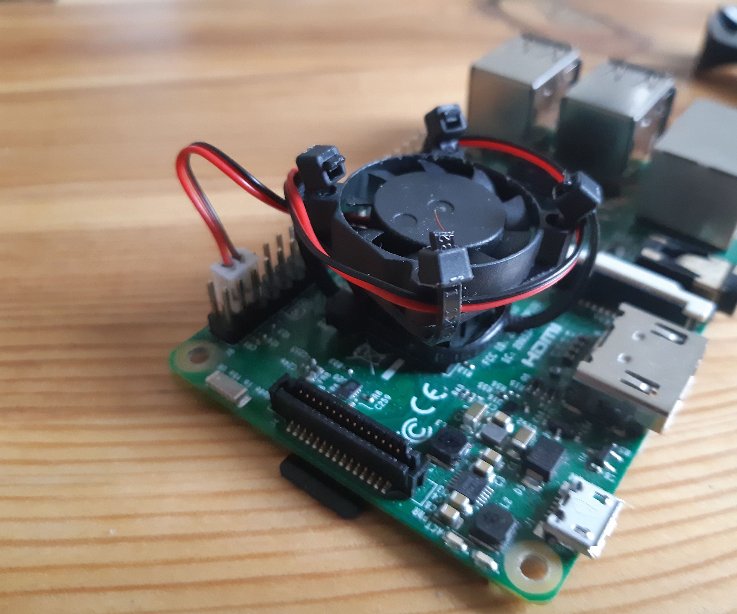

Step 6: Assemble the Hardware Into the Plastic Part
This is the easy part, get a small file to correct the print defects and make everything fit, the right procedure is :
- Insert the USB hub
- Put the fan over its hole and screw it tight so that it doesn't shake, if you are able to find little rubber washers, they can prevent the thing from shaking as well.
- Insert your Raspberry Pi and screw it in place. Connect the fan to the GPIO of the Pi according to the image and test the whole thing : if the pi is powered and the fan doesn't spin, you need to invert the connector.
- Plug your SD card, Wi Fi and bluetooth dongle into the Pi, slide the plastic part in and put screw the whole thing together.
Once this is all assembled and your software is ok you can finally PLAY A GAME !
