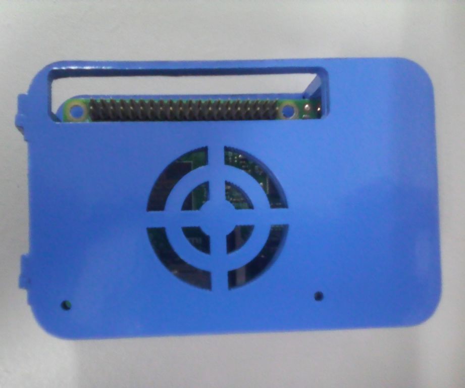

I made a case for my pi using laser cut cardboards. I just stacked 2 folders (4 layers of card boards) using super glue or instant glue and had a CO2 laser cut my design. The front cover of the pipboy was also cut using laser. The file is in DWG format. Use NanoCad to open and modify this drawing. NanoCad is freeware too. :) If you have steady hands and can't get access to a CO2 laser cutter, you can just simply print them using an ordinary printer on paper. Paste is on the cardboard and cut them out using x-acto knife. Be sure to use 1:1 scale and units should be set to mm.

I basically just made a larger base for rpi case to sit on. I added ears on the case so I can insert a thin strip of EVA foam to act as a securing belt. This way I can still remove the pi without destroying the build. I also mounted the power bank on the other side. It is secured by simply making a hoop tightly on the power bank's body using strips of EVA foam and gluing it on the securing belt of the rpi case. The belt is held in place using an old watch locking hatch. If i did not have this I would have probably just glued it on the arm holder.
